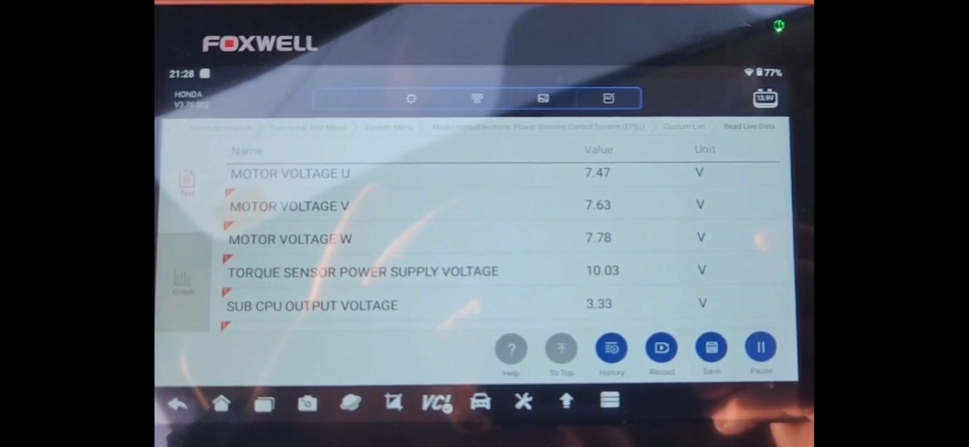

I've done some testing. I cleared dtc and they didn't come back. But watching the eps live data the sub cpu voltage seems really low and jumps between 2v and 3.3v. looking at the ECU live data it says the eps signal is low?.

There's lots of EPS signals - that's not a useful label. Does it have some kind of ID or description if you select it on the scan tool?
There is a "Sub voltage" listed in the wiring connections (control unit pin B4). Looks like it's the torque sensor's secondary (redundant) signal, which should vary from 1.7V to 3.3V with steering wheel torque. The center (no torque) value should be about 2.5V. There's also a main signal on B2 that varies in the opposite direction.
