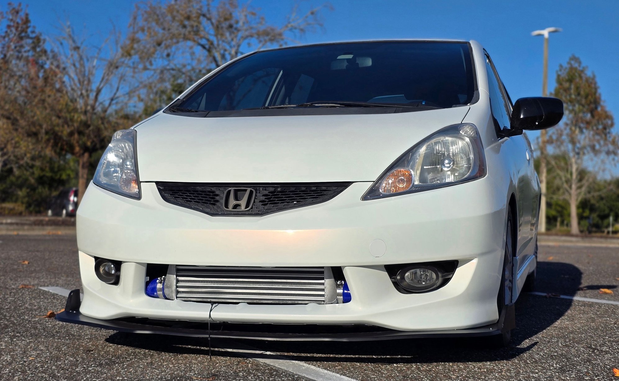

As far as paint on the Fit I used Toyota super white base color, second stage of clear base with copper interference pearls, then standard clear coat. All sprayed in my mother's garage that she let me borrow.
Planing on running 5-7 PSI no clue the conversion for air volume but it's a GT 2871 lol

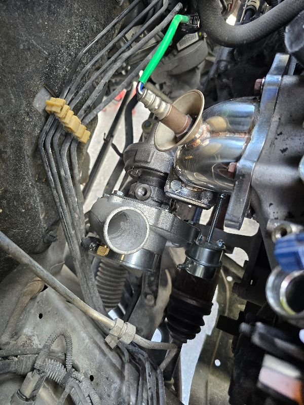

Also here is some turbo fabrication pics

You're not going to be able to convert boost pressure into an airflow mass sum. You'll have to use whatever tuning software you're going to use to see the MAF/MAS sensor's output (though sometimes it just sends data to the ECU which then calculates it) Boost pressure is technically a measure of a restriction of moving a mass of airflow. Think about it this way. 30psi through a straw isn't nearly as much air mass as 2psi through a 4" pipe and it's that mass of airflow that matters, that's what we're needing to burn more fuel under the right conditions to make more power. 17 lb/min I'd approximate to be generally speaking around 150hp worth of airflow, this is a very generic assumption way to many variables to nail it down and apply to every gasoline engine. But seeing as these L15A7 engines in the GE cars only make 117hp new, stock... I'd suspect that's maybe 13 lb/min. I learned this stuff as I had too, to tune my 1990 Eagle Talon TSi "back in the day"... had that car almost 20 years before I finally let it go, which I kind of regret. Anyway I don't know if you have seen the internals on the L15 series of engines, but um... though you can beat the hell out of them on the auto cross and circuit track all day, producing a large amount of power for their displacement is not something they're even remotely close to being built for... So I definitely wouldn't would get a good idea of what the engine flows stock, and not go too far above that... which sucks cause well that's a lot of time, work and money to turbo a NA car... oh and the compression ratio isn't going to be very friendly to boost. 10.4:1 I think it is?
