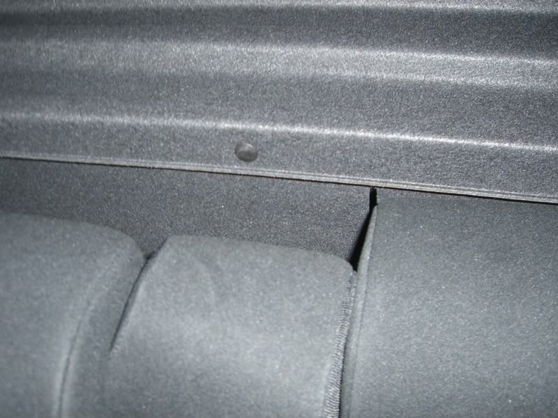

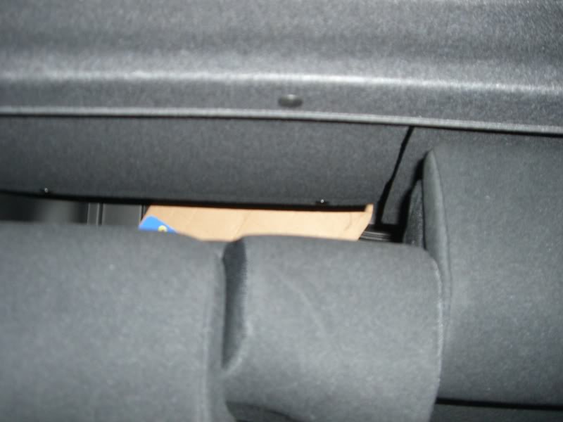

Here are the pictures of the cargo cover:
These two pictures show the gap between the cargo cover and the seatbacks with one reclined and the other not.

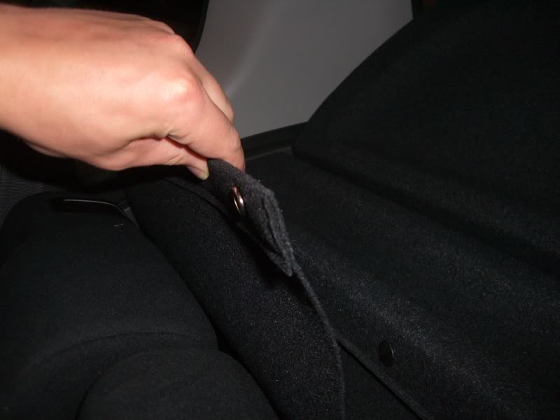

This is a picture of the flap. Its utility seems marginal at best.

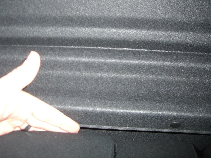

The gap between the cover and the seatback is no larger than a finger when reclined.
Well, if you don't like it, just cut it off. It IS your car, right!? The instruction PDF show measuring down 44mm from some reference, a seam, maybe. It also sounds like there are holes already in the solid material underneath the cloth cover, you just need to locate those holes holes, and insert screw there. Good luck!
