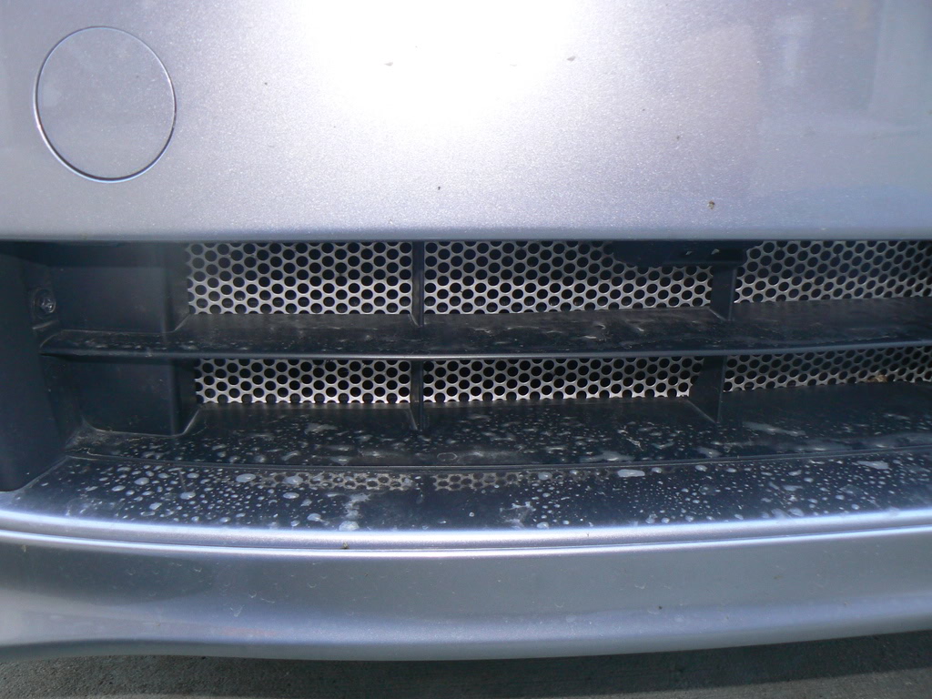

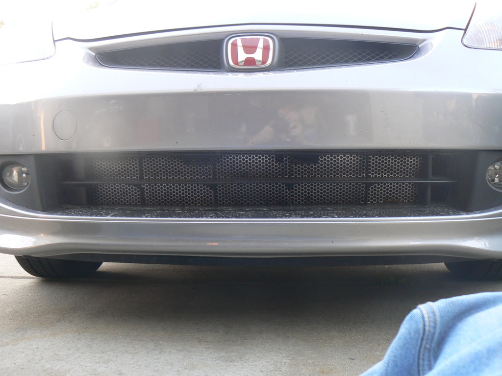

Ask and you shall receive. I just went outside to take some close ups for you. And please excuse my very dirty car haha
