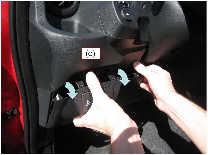

Steps to Remove the Fuse Panel Lid
(A) Grip the handle opening of the panel with your left hand.
(B) Place the fingers of your right hand behind the lid’s upper right corner.
(C) Press your thumbs against the dash and gently pull on the top of the lid with both hands to
release the clips.

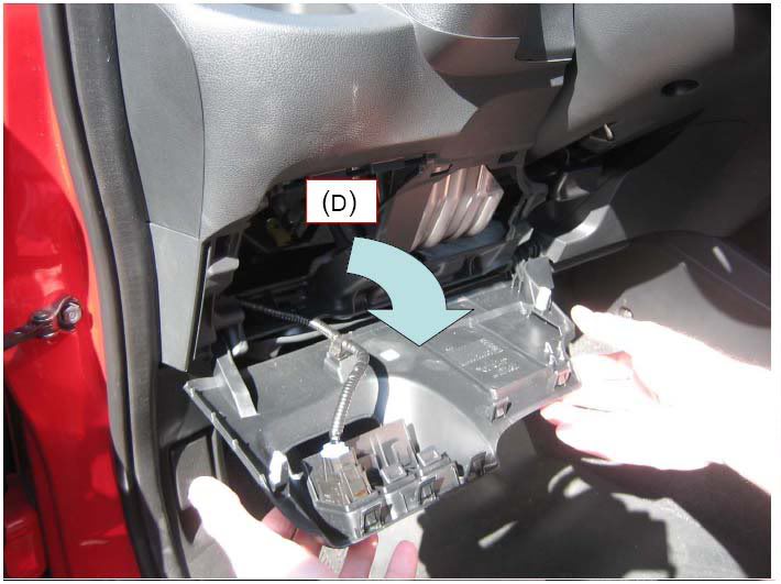

(D) Gently let the fuse panel lid swing down.

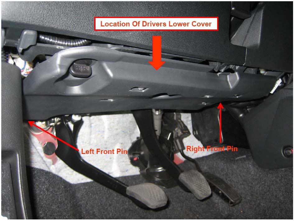

Driver’s Lower Cover Assembly

Drivers Lower Cover
1. Insert the left front pin completely into the support holder.
2. (A) Partially set the right front pin in the support holder and,
(B) Align the right rear clip with the retaining slot, then tap the clip into the retainer.
Installing the Driver’s Lower Cover.
3. (A) Push the left rear corner of the cover up into position and,
(B) Turn the lock knob to secure it.
4. Inspect the cover to verify that the pins and both clips are set correctly
