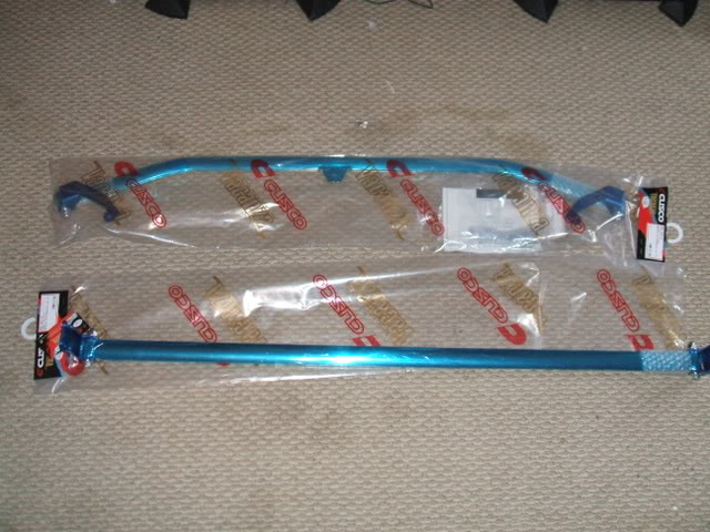

Hello all my people, i just got in my front and rear strut bar from Japan today and only had time to install the rear. so i wanted to do a little write-up on the install so here are some pics and info

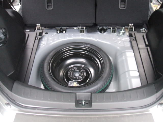

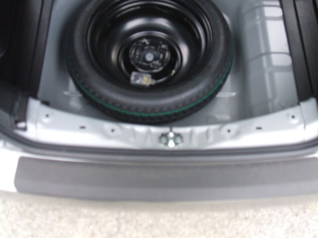

start by removing spare tire cover

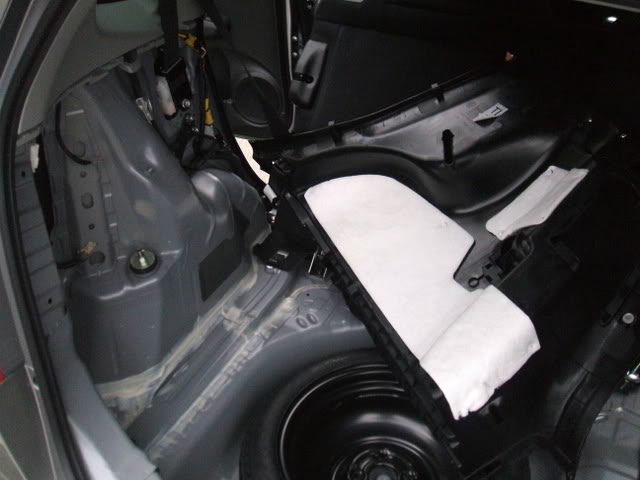

then i pulled on the driver side quater panal plastic and poped it loose and moved it to the side

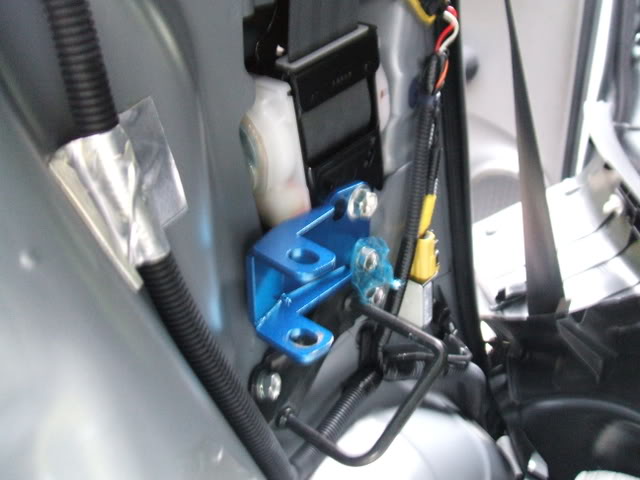

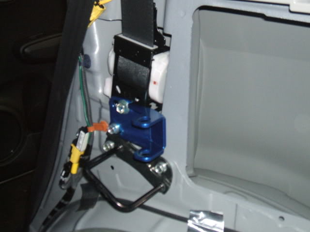

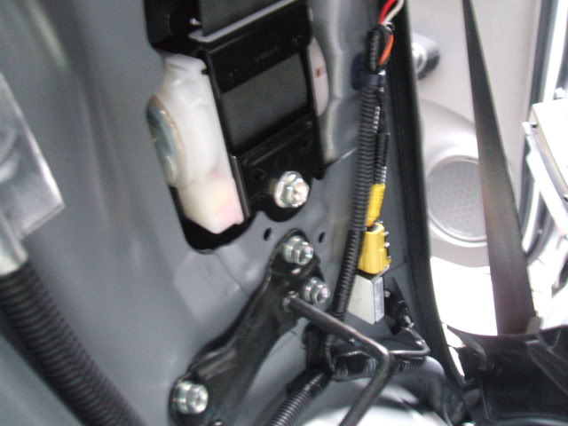

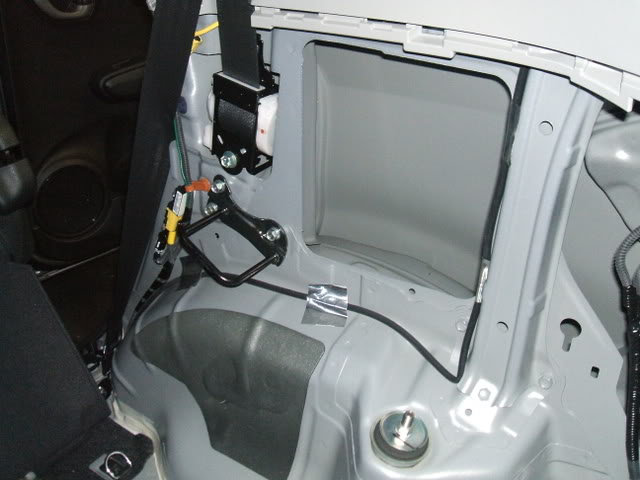

then took the end of the strut bar off and bolted it to the two bolts in the pic (14mm) and (12mm) sockets

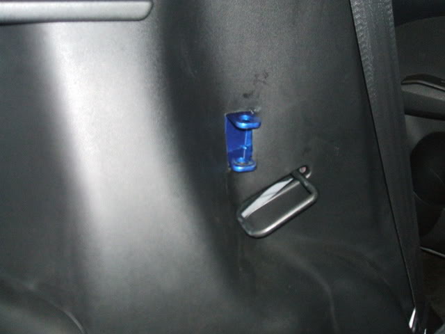

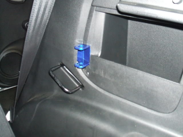

and on the passenger side i popped the plastic peice off and bolted it into similar spots as the driver

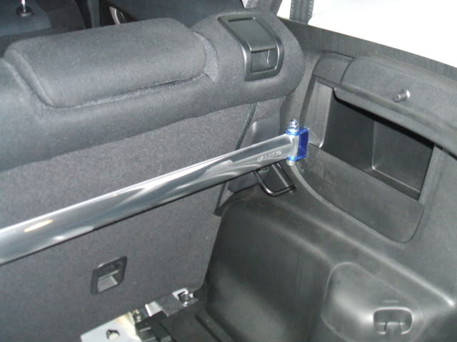

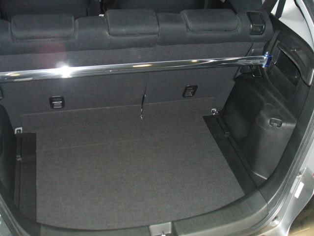

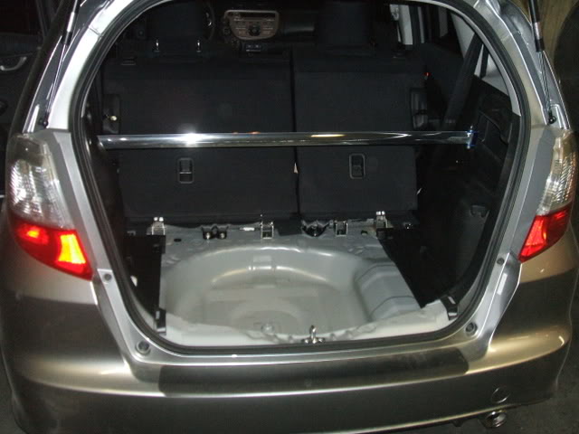

and walah!

doesnt that get in the way of the full mobility of the rear seats?
Old Oct 24, 2008 | 01:52 AM
mole177's Avatar
Posts: 877
From: Armenia, So cal
^ i was thinking the exact same thing... if it does, no deal for me.
If you wanted to lay down the seats it would, but its super easy to just remove the bar from the mounts and reinstall after your done halling whaterver it was that was in your way
