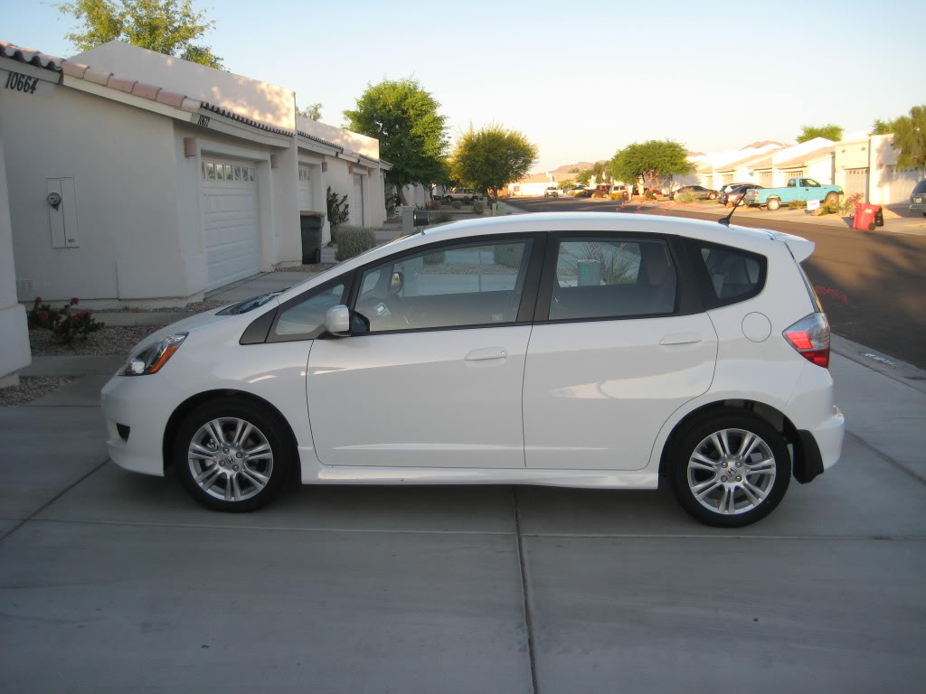

These came on the fit when I bought it as an option. Perfect fit no gaps and I cant see where dirt could ever get trapped.

I must say, after looking at HardCorpsFIT's picture, I think the side skirt acts a little like a mudflap for the front wheel (albeit a small one).

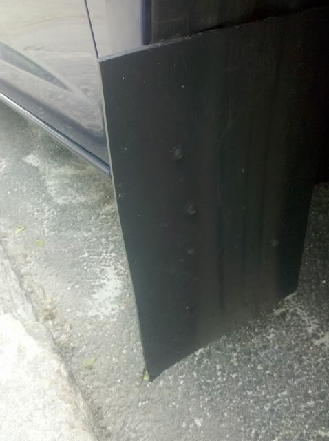

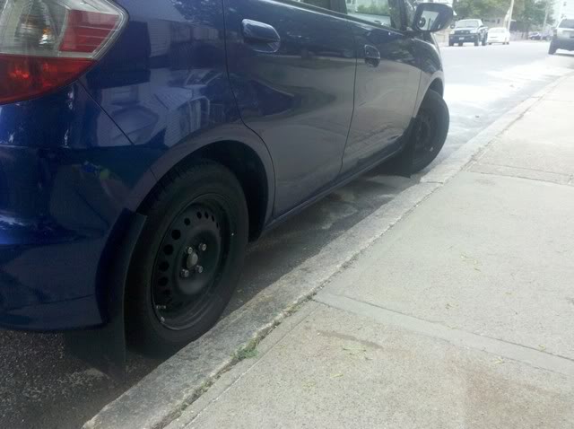

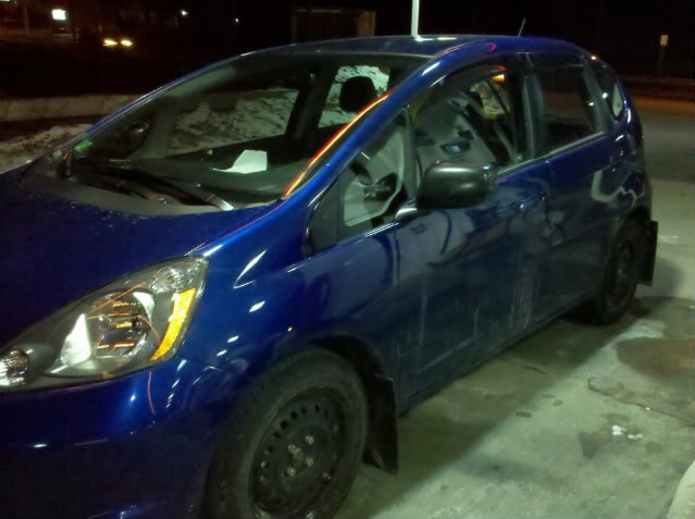

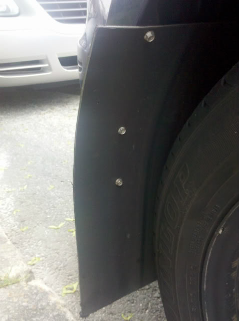

1 semi truck mudflap cut into 4 pieces. It cost $7. Secured using stock harware in front, self tappers in back. 1 RI winter sans flaps wore the paint off both rockers, was able to get it repaired under warranty though. They have the added benefit of rubbing curbs before the tires, provided you mount them so they hang low enough.

They also rub the road under very, very hard cornering. Though that has gotten better since adding the RSB.

Definitely a case of function over form. For only $28 more shipped to your door you could have got a genuine Honda set that compliment the looks of your car. Your DIY set actually look dangerous to me with the very sharp edges sticking out. Somebody walking around your car could get cut on those edges.

Had them, they suck (see my earlier reply). They are sitting in my spare room with my seats and muffler. wanna buy em? The DIY ones are made of a soft plastic, so no chance of injury, unless you poke your eye on them. And yes, function way WAY over form. This car gets driven hard, I'm much more concerned about how it works than how it looks.

OH GOD that looks so tacky.
