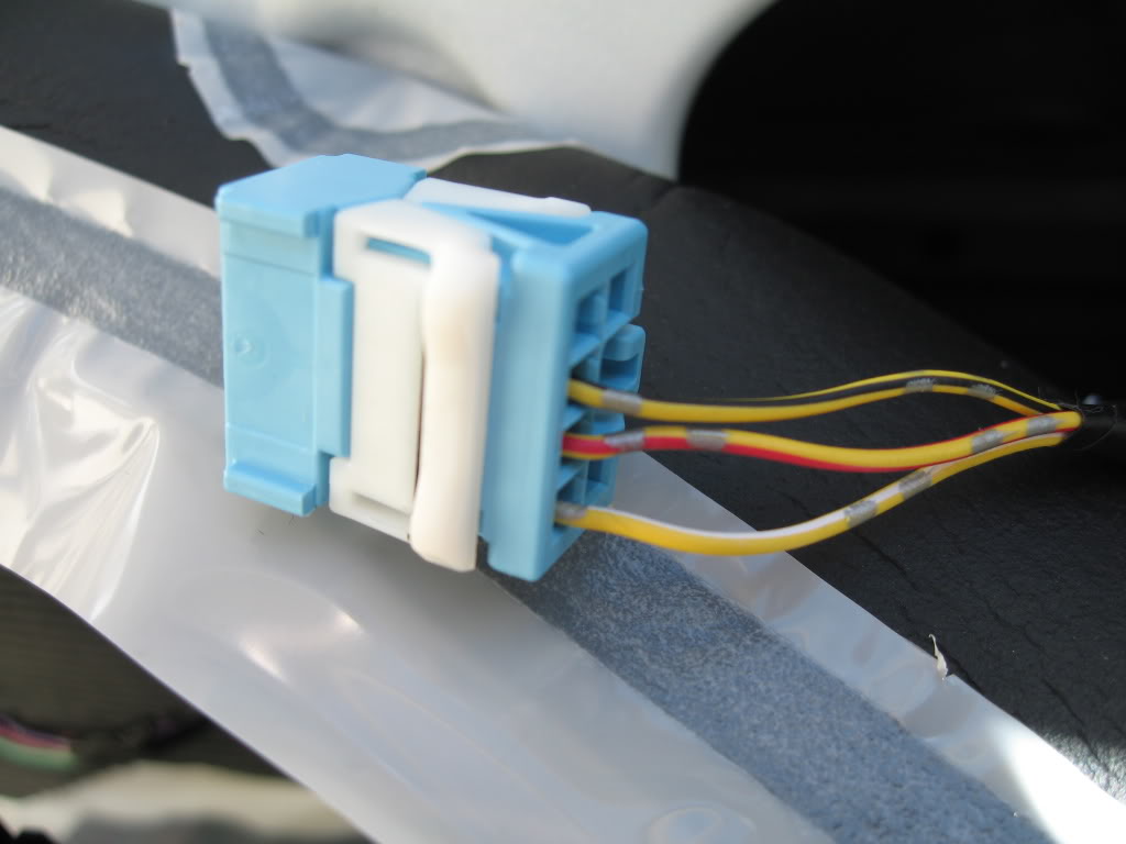

Here is a pic of the US mirror harness..... you basically have 3 pin locations that can be used that are open... So you will need at least 2 per connector.. and the fun part will be wiring each door harness to the main fuse panel..
