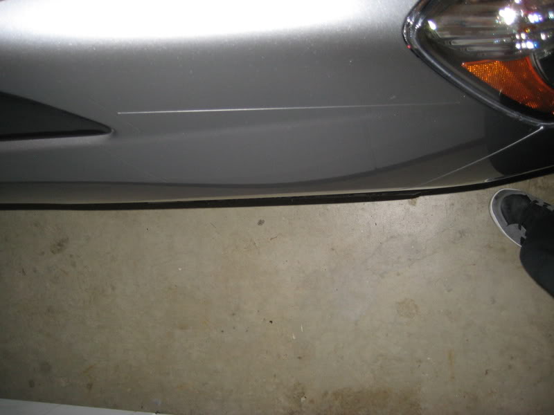

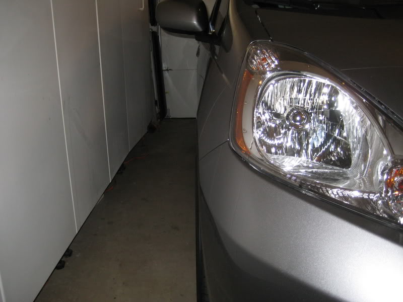

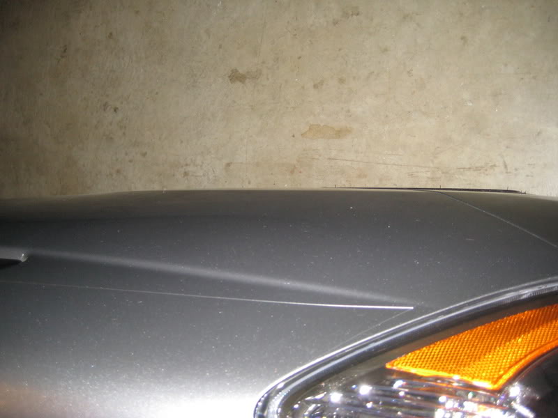

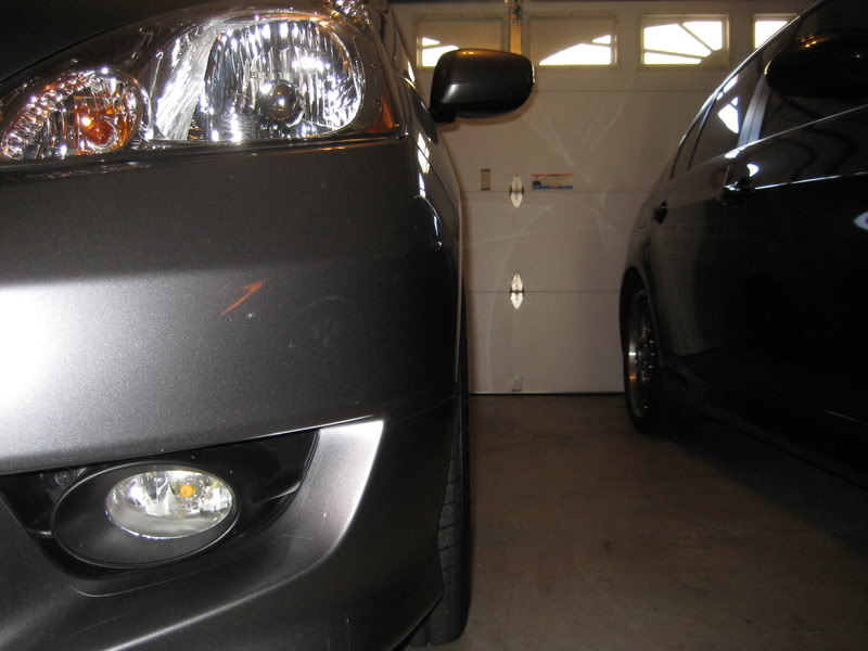

so i have +42 offset rims 7.5" wide and 205/45/17 tires and i dont rub anymore! i used to rub on hard turns but now i dont. i got some camber bolts and gave it some negative camber only 0.5 deg on the driver side and 0.7 deg on the passenger side. just wanted to let you all know if you were iffy on what size rims you guys wanna get for your fit.

Nice man. Camber does magic for rubbing.
What car is that next to the Fit?

06 BMW 330i
