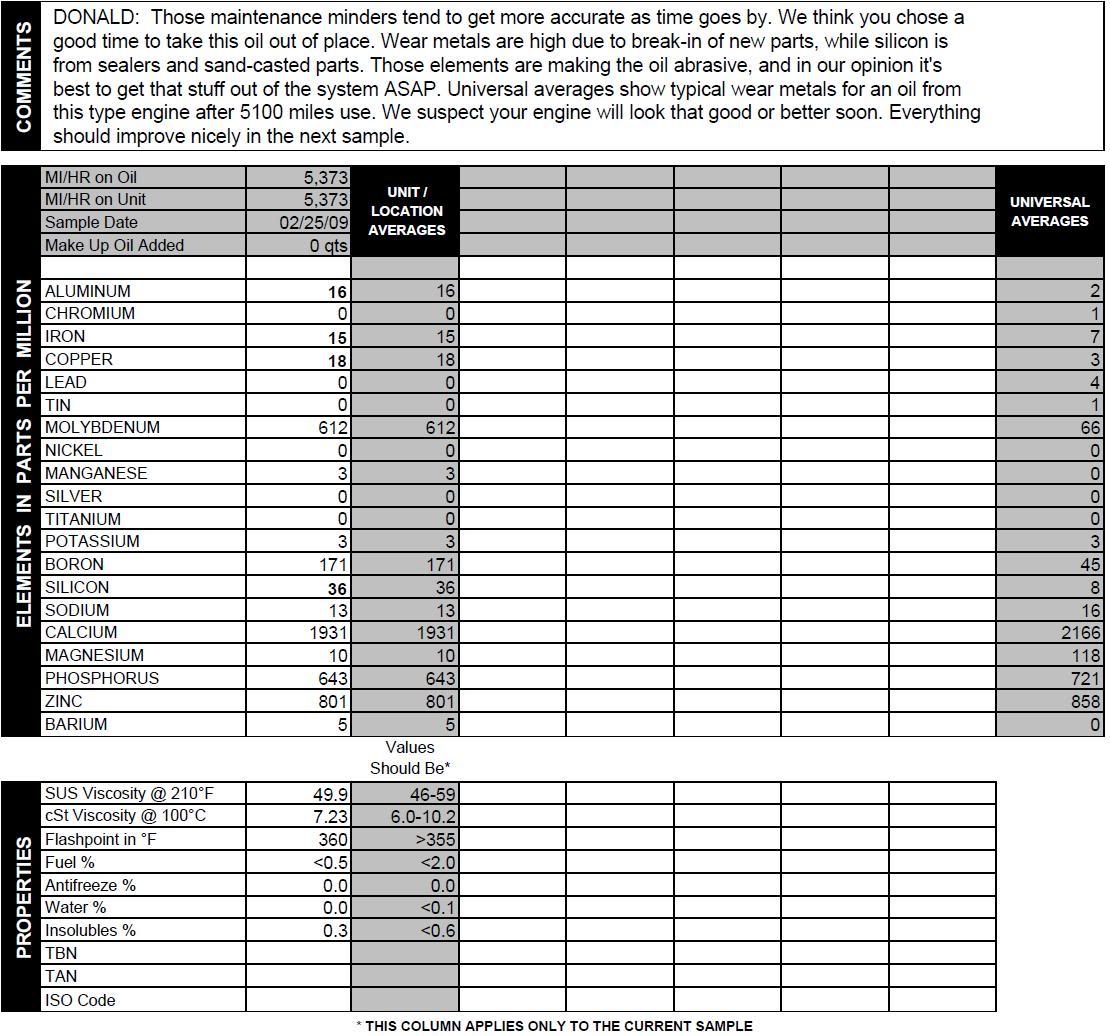

My oil analysis results
So after my 1st oil change I sent in a sample to Blackstone labs. Here are my results after 5,373 miles with the maintenance minder at 60%. Thoughts?

I'll + rep that. Thanks for posting. Makes me think about my next oil change.... being done sooner than later

Noticed the extra moly in Honda's break-in oil?

Nice post. Thanks. This makes me happier about my decision to change the oil before the Maintenance Minder hit 0. I just changed it over the weekend at 6,700 miles with 50% showing. As someone who changes their oil around the 4,000 mile mark, I was getting quite nervous about letting it get so high.
So... I'm confused, the lab report said it's better to change the oil as soon as possible, but then isn't Honda's break-in oil supposed to stay in for at least the first 5k miles? I'm at 3,700 and my dealer said to change it at 3,750 but the I swear I read somewhere the Fit's first oil change is at 5k. What to do?

Nice job getting the analysis done. How much was it? Might have been nice to see a little more data. Here's a site for some good info. The Motor Oil Bible eBook Some parts need to be taken with a grain of salt. I only read the free stuff and didn't pay for the extra, but it has was worth reading.

You must drive like a maniac, most people do their first oil change around 5000 and the oil life meter still reads 50 or 60 percent.
Remember guys the meter doesn't analyze the oil at all, it just counts the numbers of revolutions and throttle position and determines the life of the oil on those factors. If you were to wait till it got to 0 or 10 percent you can probably go 12,000+ on the original abrasive oil. It just sounds like a way to save honda money on oil changes, and by the time that mechanical problems show up after waiting that long to change the oil your warranty will be out. Change it at 5000 and play it safe.

$22.50. It took about a week and a half to get the results.
