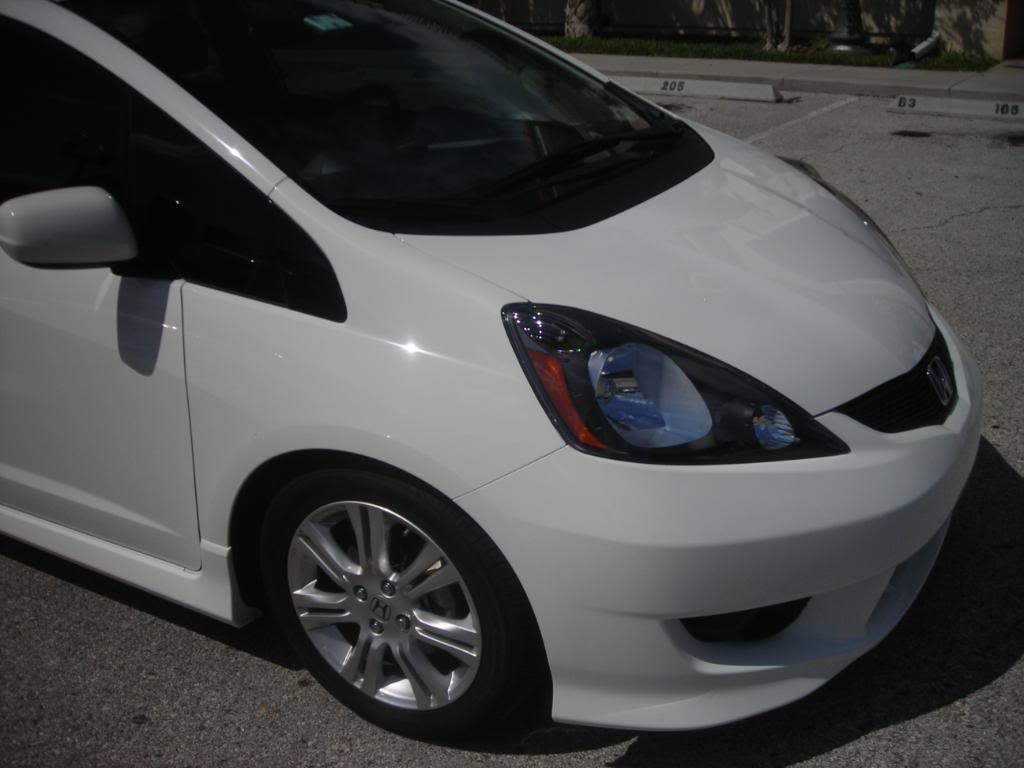

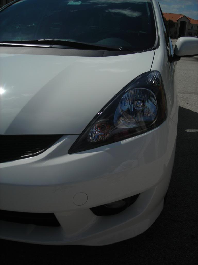

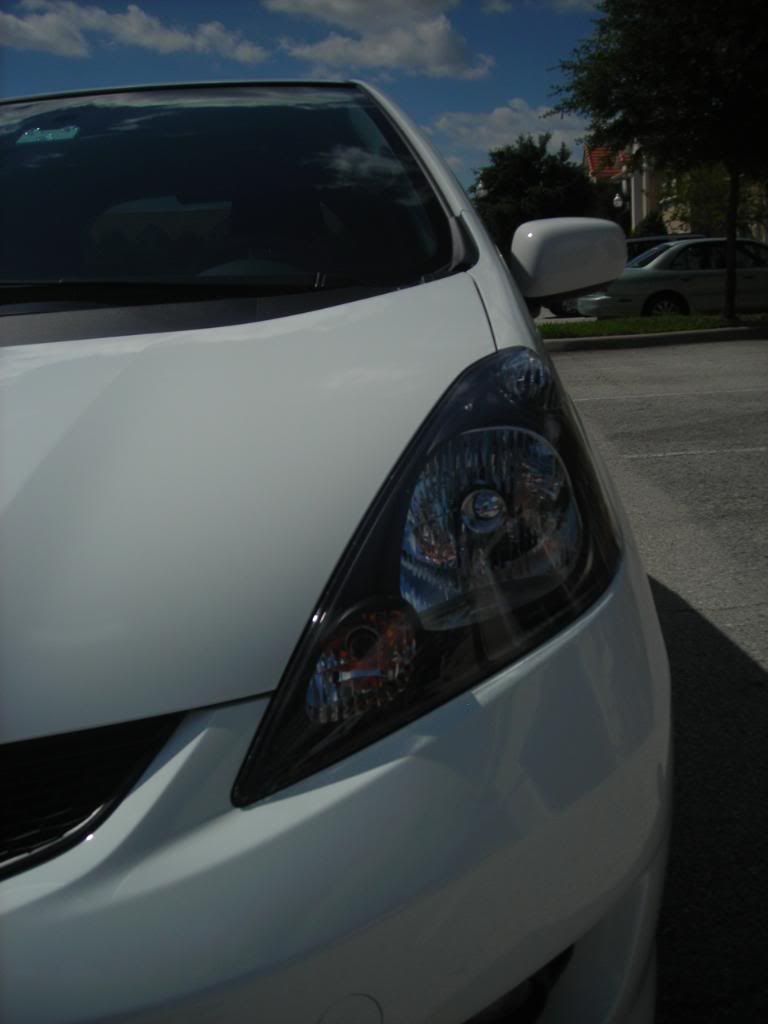

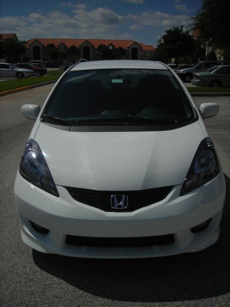

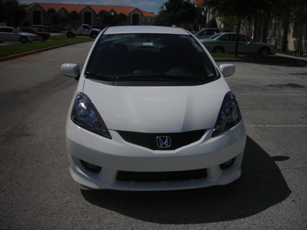

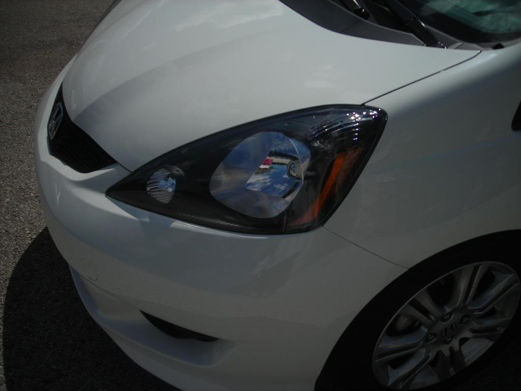

Blacked out headlights... Oh yes...

sweet, but the pictures a little deceiving 'cause of the dark lighting....can you take pictures with better lighting?

did you just do a flat black? can't really tell. Though I would have gone with a black with sparkles, my JDM integra Type R headlights came that way and looked great.
Old Apr 6, 2009 | 04:19 PM
qbmurderer13's Avatar
Posts: 2,373
Yeah I went with flat black so it wont look too flashy or look aftermarket. Looks like it came this way and matches really well with all the other black trim and the grille. Ill take better pictures soon.

So you did the oven thing I take it?
What brand/type of paint? Is Nick next for this?

Originally Posted by Tork
Ahhh looks great!
Lol actually he helped me do it. Plan was to do both our cars but we took a pretty long time on mine and we were both kinda tired. We tried doing it without removing the bumper but found it easier to just remove the bumper. And yeah we baked it at 300 for about 4 minutes and it came apart easily. Re used the original glue and haven't had problems with today rainstorms and me washing my car today. Used krylon flat black over duplicolor adhesion promoter. Nick will have his done next weekend
