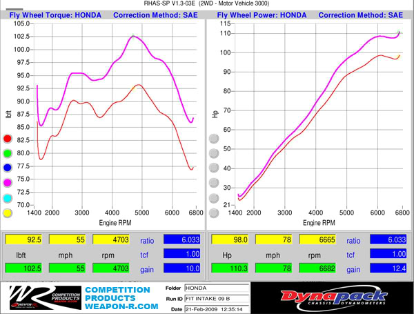

Originally Posted by manxman
As your dyno charts proved, the new gold standard for after-market intakes is now >7whp!!!
but my intake's dyno was more than 7 or 8hp.
Yes... and that chart displays the kind of attributes that make me skeptical.

So we have an extremely exaggerated dyno... And a dyno that doesn't start till 4k and shows a 7wtq loss... Great.
Seems like people are making such a big deal over one or two ponys. If one intake makes 7whp and the other makes 4whp I promise you won't feel a difference between the two. If your main objective is power wait for a FI kit to come out.
You're comparing a Dynojet to a Dynapack. Dynojets measure hp on the wheels, while Dynapacks measure hp at the hub. Of course both these numbers are relative only really to the dyno they were tested on, but IIRC, Dynojets tend to report more conseravtive numbers (And, while they make cross-car engine comparisons much more difficult in terms of different wheels/tires/brakes/etc, I feel they are more accurate to real world performance).
Also, I see @ the top of the chart "flywheel". Were they testing the hp@ the hub then "correcting" for what the operator felt was the @ flywheel HP?
