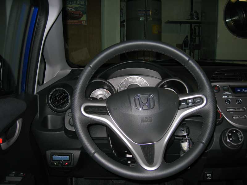

A few pics (sorry I always plan to document the whole install then get too excited and forget to take pictures):

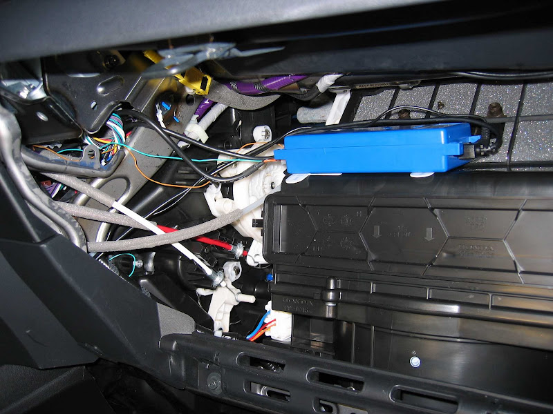

Parrot control box, blue box mounted above HVAC air duct. Wires on left go to harness, (thin brown and green ones not used, might clip those eventually). Wires on right go to display and mic. I used those Command strips to mount so I could remove them in the future:

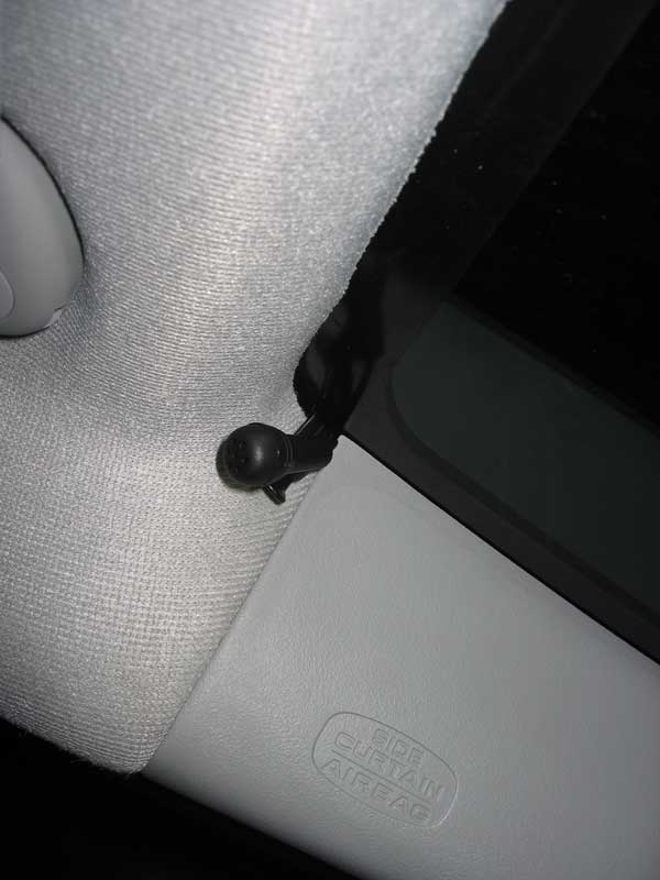

Mic closeup:

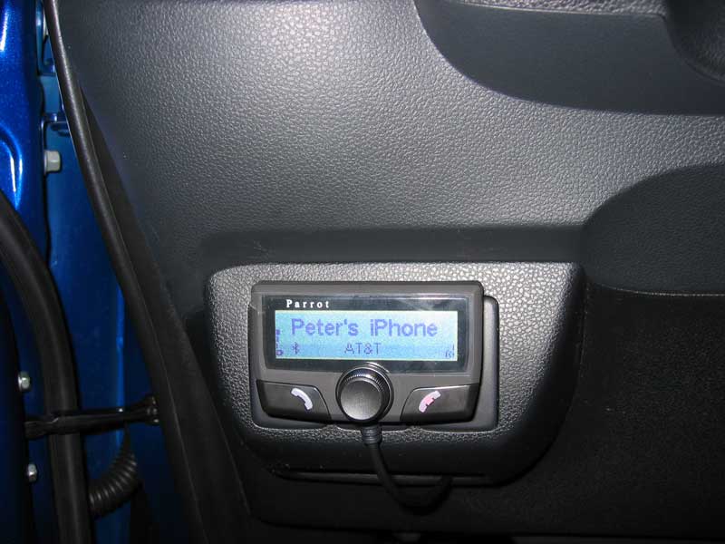

Display closeup- note signal strength and phone info:
Display driver's view:
