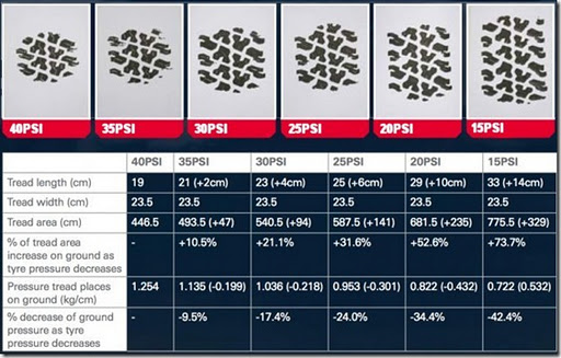

Old Jan 4, 2013 | 01:39 PM
  #105
Mini_Odyssey's Avatar
Joined: Dec 2012
Posts: 547
From: Socal
Old Jan 4, 2013 | 01:49 PM
  #106
mahout's Avatar
Posts: 4,371
From: NC USA
Originally Posted by nikita
Within normal operating limits, yes it does. Pneumatic tires used to be called balloon tires for a reason. Do this simple experiment, that I was assigned to do in high school physics class. Inflate one of the tires to 20psi, jack up the car and lower it on to a piece of graph paper. Measure the contact patch area. Do the same at 30psi and 40psi. The original experiment was to prove that pounds per square inch means just that. The contact patch area times the air pressure equals the static weight of that corner of the car.
I, too, have performed that experiment except carefuilly cutting out the contact patch and then weighing them. Trying to measure the area never satistically worked; too much variation in the 'area measurement' to adequately measure. Party balloons will indeed change contact directly with inflation pressure but tires do not; the tire structure prevents that.
In fact, if you have a truck tire you won't get much change at all. And if the structure were a brick there definitely won't be a change at all. The pressure to the ground is the 'vehicle' weight divided by the contact area, whatever it may be. That pressure does greatly affect the interaction between the tread and the 'road'. That pressure is vital to the 'tenticles' the tread inserts into the road surface toi achieve grip. And thats why the ideal pressure is only valid for that one instance.
The rigidity of the balloon has a lot to do with the change in contact area.
And back then balloon tires were a lot closer to balloons than now. Tire structures have come a long way since then.
Old Jan 4, 2013 | 02:08 PM
  #107
Joined: Dec 2012
Posts: 547
From: Socal
I too was under the impression that tire contact Patch was based on weight and air pressure, is this not true?
Old Jan 4, 2013 | 05:36 PM
  #108
mahout's Avatar
Posts: 4,371
From: NC USA
It is indeed. The difference is the contact patch area is not DIRECTLY related to the tire pressure. As tire pressure changes the contact patch also changes but not directly, For a 10% change in tire pressure the cointact patch area changes about 3%. The amount of change varies with the tire construction, virtually every tire is different. The main affect is the tire inflation pressure changes the rigidity of the tire structure and that appears to be a major affect. Thats why its so diific ult to predict the change in handling as any NASCAR or F1 team can attest.
That help? Its a trend not a plot.

Old Jan 9, 2013 | 01:45 PM
  #110
Wanderer.'s Avatar
Posts: 4,363
From: Hayward, CA
Tire pressure is not directly proportional to contact patch, as in 1mm=1psi, but they are related, that is the key. The experiment Mini_Odyssey posted supports this. There are many variables that change this relationship from tire to tire and car to car, surface to surface.
Improving handling does not always mean bump the tire pressure up as high as you safely can, there are other factors in play. Your suspension has to be able to compensate for that extra rebound. You are also finding a sweet spot between lateral and forward grip... losing some pressure gains you some contact patch (forward) but adds more tire deformation and hurts your lateral.
Another reason track guys run higher pressure is tire wear... try hot lapping low pressure on track on non-R tires and tell me what happens to your tread
At least this has been my experiences, which are far from scientific, just pieced together through common sense thinking and personal experience.
