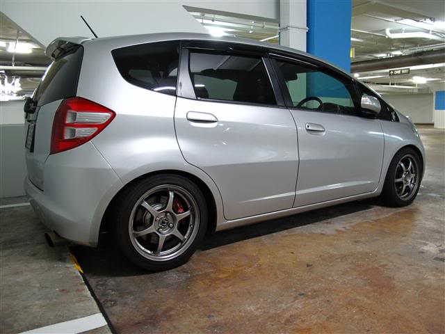

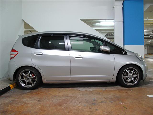

not here to argue, just to share some pictures after reading all the posts here
here's a JDM GE converted from rear drum. discs size 285mm with a 2pot caliper. i'm not sure what is the make of the caliper, if anyone has any info, do advise !
both the conversion was done mainly for aesthetic purpose, primarily. and occasional casual tracking being secondary. But ONE thing for sure, acceleration from stand still felt a little retard when floored the gas pedal. FC increased too
require a 15" rim minimum to clear the rear caliper due to larger 285mm discs. this JDM Fit also has upgraded front to 285mm, retaining stock caliper. i think stock GE Jazz is 230mm rear & 262mm front.

here's a side view.
