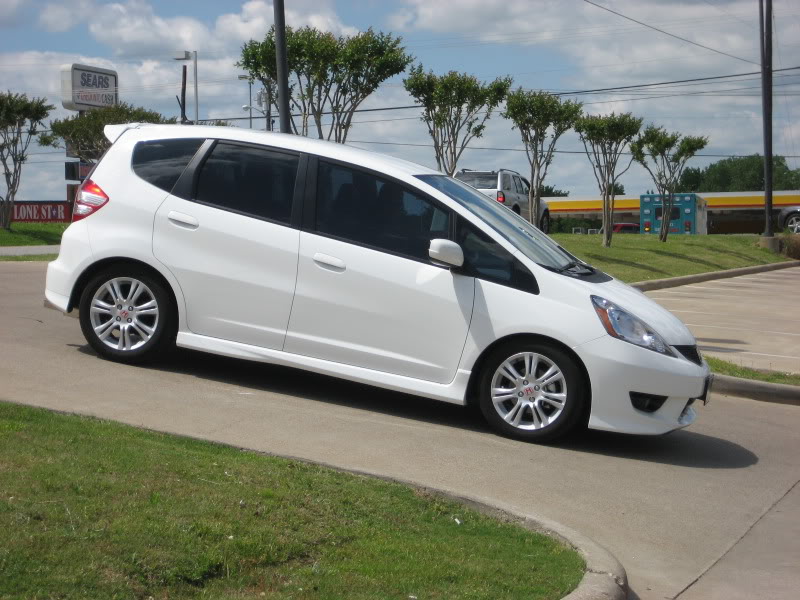

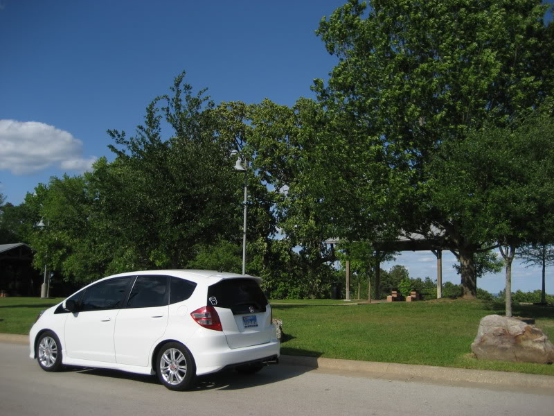

I cannot stress enough how much I love the Swift Springs...
Here are some pics.

The ride is great! It rides smooth as silk on regular roads and gets firmer only on bumps. And even then, it's not "rough" it's just firmer.
I've ridden in cars with buddy club coilovers (really harsh), Ground Control's (eibachs on sleeves--pretty nice, but stiff), HFP Suspension (my favorite next to my Swift's but they were $800 for my EP and discontinued now)...
So, for the $250 I paid for my Swift's, I don't feel I could have done any better!
Keep in mind that I am a woman, and have a family and 2 step kids...
No one complains about the ride.
They thought for the first week or so it was a little stiff--but the springs have been on for a few months now, and they said the springs/ride feels better and they don't mind it at all.
