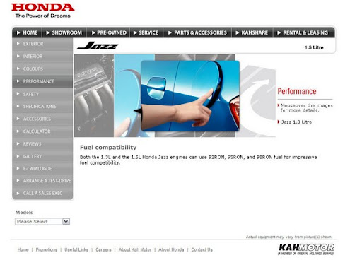

Your writer in Malaysia uses 97 RON because the next lower grade is 91. Honda in Asia requires 92RON minimum (not the 95 your article states). 92RON is about equal to 87 octane here (using the R+M/2 method).
This is from a Honda site in Singapore.
The same honda site makes no claim that performance differs according to the blend of gasoline used.

You went back to far https://www.fitfreak.net/forums/1st-...tml#post854992. Thanks for making my point 1.3,1.5 can use 92 ron,95 ron and 98 ron for impressive fuel compatibility.
sigh... you do realize that we don't rate our fuels according to RON don't you? That's only in other parts of the world. We use the average of two ratings RON and MON, the ol' R+M/2 method that's posted on the side of every single gas pump in this country.
92 RON is equivalent to 87 octane in this country (using the R+M/2) method.
What is your point? Nothing in the article you posted or on any Honda website, or any article about Honda written by a reputable magazine states the Fit (or any other economy car) gets better mileage/more power by using premium fuel when it's not required/recommended.
