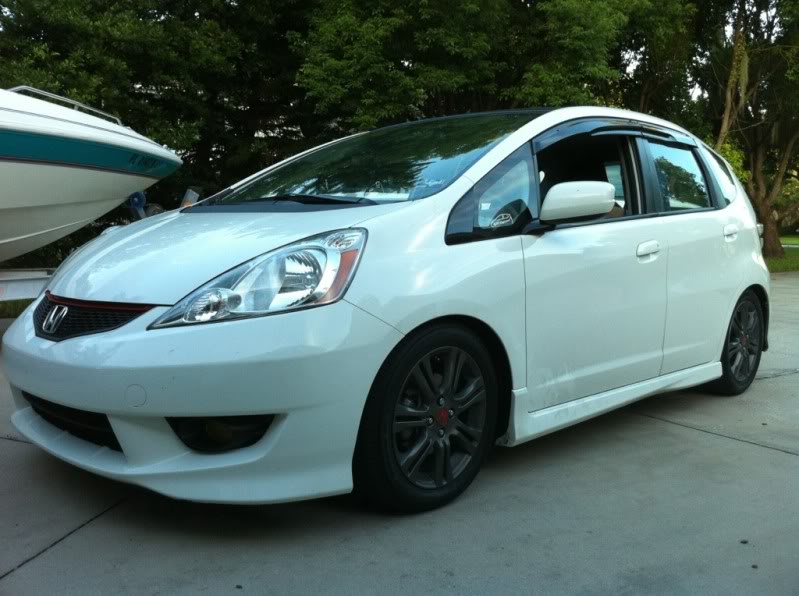

i love the fact that this is such a great community. everyone so willing to help as much as they can. I know there are about 4 or 5 threads on here about axle's popping out and no one bashed me and told me to search in a time of need (which i had already done anyhow). thanks a ton for the help and advice.
and here's for the help...
i'll get some more shots up once the car is clean.

Glad we could help! Fitfreak.net is an awesome forum. Liking the drop and wheels.

+Rep for joining the lowered club (and having it be a pain in the ars)
Looks really good.

Ha, thanks for the rep. If I knew what I knew now, it'd only take about 2 hours. The other three wheels flew.
