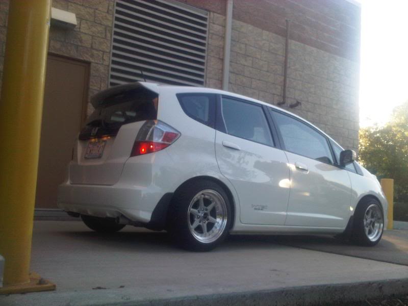

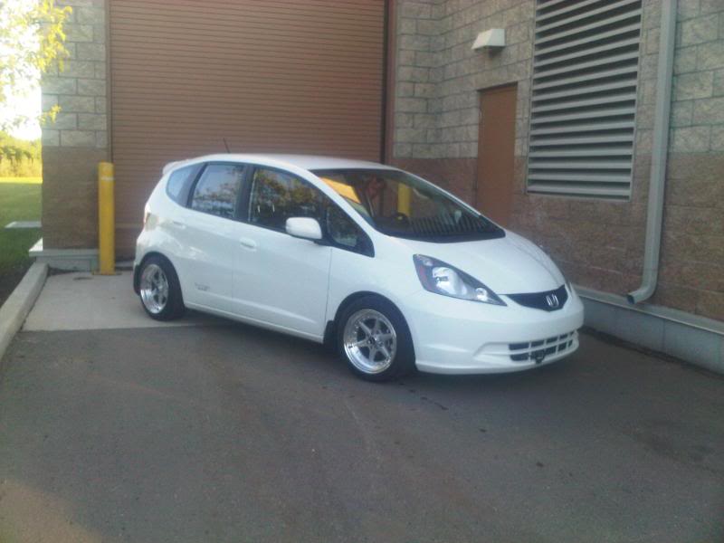

I beg to differ. I have a GE8 with XXR 501s, 15x8 +15mm offset and I'm lowered on Eibach Sportlines, I have MINIMAL rub in the rear, only on the worst bumps. The suspension just doesnt compress enough to rub. Tires are 195/50. Still have full steering, no modification to fenders/quarters/fender liners.
Not sure why most Honda owners are so afraid of offset.. With 16x8 +15 you would probably want to roll the quarters. With 16x8 +0 offset you would most definitely need to roll.
XXR wheels are cheap, cheap wheels, made only to drive on and look shiny. As far as performance goes they are pretty heavy (my 15s are 15lbs each). But I doubt a fit could break a wheel from tracking or power lolll. But they are also 100 bucks each give or take, so if you break one on a pothole you won't cry.

I don't know what you guys are talking about. Maybe your sport models are different some how but I have no rub with no modification to the fenders or camber. As I say I could probably use a tiny bit of camber in the back, but it rubs so rarely that I don't even think I need to bother. On top of that when it does rub, it rubs on the stretched sidewall, not the tread. I inspect it every day and the worst I've seen is a bit of tire shine on my quarters. In the front, its never touched.
Anyways this is just my experience with wheel fitment on the GE8. You guys all have your own opinions, I'm just sharing what I've found. Take from it what you will.

Yes I do think that deflecting the force away from the quarter by contacting the angled sidewall is better then driving all the force straight up and into the quarter with flat tread, thanks for asking. Obviously neither is ideal but as I mentioned earlier it rubs so rarely that I'm not going to bother rolling and potentially damaging my quarters/fenders. Yes I'm experienced with rolling, I've used the eastwood professional roller on my previous turbo civic. Not worth the hassle. If anything, ill spend 70$ on some camber shims+bolts and that will be plenty of clearance.
