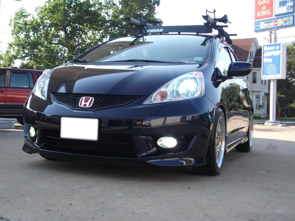

here's a pic of the front and rear
Im not positive of the drop that they gave me. They are actually a GD spring and not a GE spring. I am gonna be swapping them out before next spring for a full coil over set up though. I want more adjustment and alil more tune on the dampening. I am also running a 5mm spacer in the rear and may bump that up to a 15mm to allow the wheels to poke in the rear as they do in the front.
