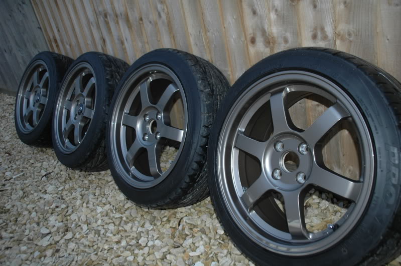

I would highly recommend 18's, I have them on my car.

They are 18x7.5 +42 with a 215 35 18
