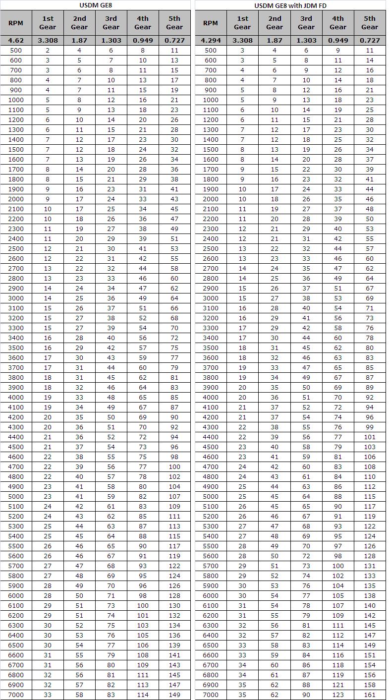

You could get the JDM GE8s FD. It is a 4.294 to the 4.62 in the NA model. I believe your acceleration will drop ever so slightly in your lower gears, but with the .72 5th compared to the .85 5th here your RPMs should drop about 200~300rpms at around 75mph. And by changing, you should be able to hit 60mph in 2nd versus needing to shift into 3rd.
Here is a spreadsheet shot of the comparison of the gear ratios with stock and JDM final drive.
