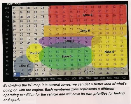

The nice things about learning how to tune by yourself and then having a laptop tunable daily driver is that you can dial in an OE quality custom tune by just making tweaks over the course of a couple months once you have the basics down.
First thing is figure out your global fuel settings, like base fuel pressure, injector latency and voltage adjustment tables. Set all timing advance above idle to like 10* tapering off to 0* under load.
Then calibrate the VE table for Vacuum and up to atmospheric pressure.
Dial in your target AFRs on the un-boosted regions of the map.
Then run some rich AFR figure (10.8:1) for the whole boosted section and start to work on finding an AFR curve you car is comfortable with. Then start playing with timing. This will help you get a feel for what you can get away with on whatever control fuel you've chosen.
I usually tune 2* of spark at a time when working on advance, 2psi on boost or around 0.5:1AFR leaner/richer.
It also helps when you do groups of like cells.
The Vertical axis is Manifold pressure in kPa, ~200kPa = 14.7psi boost (1bar)
100kPa = atmospheric pressure, or WOT on an NA engine.
0kPa = 0 inches Hg = -14.7psi gauge pressure
The Horizontal axis is RPM.
The VE table is based on engine load and a well calibrated table will look exactly like the torque curve you would see on a dyno. (That torque curve is how you figure out whether or not a compressor will work well on your car)
Depending on throttle input and turbo/supercharger type you will travel through the table in all sorts of different ways. The lines I added show different throttle input:
You can get a drivable, boost-able tune made usually in a couple hours provided everything is installed and operating properly, faster with a basemap.
