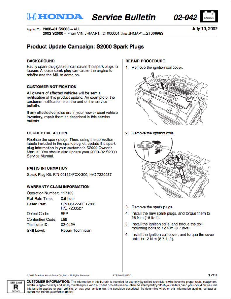

This sounds like the old S2000 recall, where the plugs were torqued incorrectly and they would take out the threads in the head as well as melting the coil. Sounds like a good time to go check your spark plug torque! I got a bunch of S2k motors from that recall!
Old Jun 24, 2011 | 08:27 PM
hybridspl's Avatar
Joined: Apr 2011
Posts: 22
From: Tampa
Sorry, should have posted this S2000 TSB in the last post.
