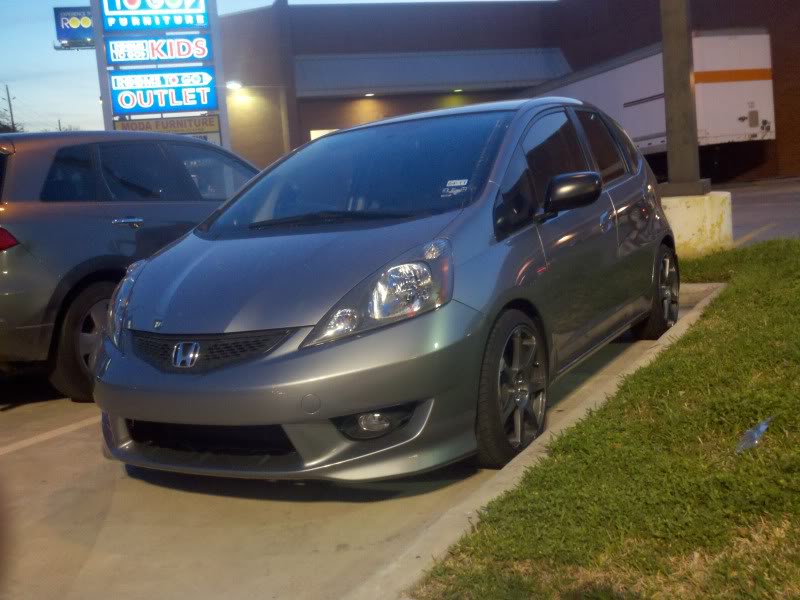

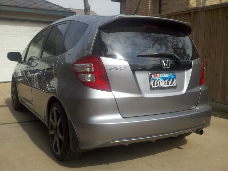

Quick question
Ok it's nice to see this ended up being educational. I've got a question for you. I bought my wheels in the blind. I had a 97 Civic coupe and ordered DR-33's from discount tire. I just wanted the ones "recommended" for that car. They put them on and no problem. A month later I bought my Fit and put the wheels on the Fit. 205/40ZR17 either +42 or +45. I only know that because another member on here let me know that the DR-33's 17" are only available with those two offsets. I was wondering if there is any way I can find out which ones they are?
Just thought I'd ask. It seems like there some wheel smart people on here. Thanks in advance for any help.
OP- My fronts seem to "poke" a little and the rears are almost flush. (They're flush with the mud flaps)
Old Mar 20, 2011 | 03:07 PM
  #59
drumsauce's Avatar
Posts: 367
From: Livermore, Ca
Ray731 - you will have to pull one off and look at the back side of the spokes. Usually there will be an embossed (raised letter in the metal) stamp with the the offset numbers and "ET" behind them. This will be your offset.
