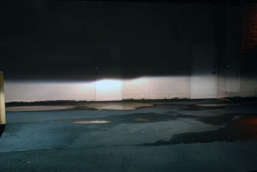

Since this debate always comes up I want to do a test and see how accurate everyone is.
Please state if you think the picture is HID projector (stock or aftermarket) or HID drop in halogen housing.
I will post the answers later.
HID1

to be honest, this won't be a fair Question as there are no standards and wayy to many variables.
is it the same camera and same night?
the ambient light is different in each picture so have the ISO & other settings be maintained?
I know drop in when I see it in person and it is awful. I also know drop-in when I'm behind the wheel of a vehicle with them because I can't see crap when I come upon a road with a larger number of street signs due to reflection.
Of note, i have light sensitive eyes (I sneeze 2-3x everytime I go out into the sun)

Agreed..but this is just for fun. Based on your personal experience just guess.
Personally I've found that stock projectors with a HID drop in is the worse for blinding. They don't aim as well as an HID drop in an halogen fixture w/ reflector shields. Any HID drop-in w/ a OEM halogen projector or standard halogen lamp without reflector shield is going to be horrible. My point is all projectors are not equal...this is common mistake.

Correct on the All projectors...
they have to be HID Projectors. I know some subarus come with Projectors designed again for Halogen bulbs. the big issue is that when a Halogen bulb is lit, only the filament is producing light so there is a specific design that is used to reflect light from that one spot in the bulb. With a HID bulb, the entire bulb is lit as it is gas that is ignited. there is no always lit filament so there are infinite angles in a 2" area (the length of the bulb) from which the light can be emitted. There is no housing (either projector or reflector) that can accommodate both types of bulbs. customizations can be made to help cut down on glare or other side effects but they will also cut down on the usefulness of the aftermarket solution.
HID bulbs belong in HID housings (whether reflector or projector), Halogen belong in Halogen housings (again, whether reflector or projector).

i do not know what you are trying to prove here. we all specifically stated HID projectors, we did not say go drop some HID setup with a full ballast kit into your mama's 09'+ camry's halogen projectors.
i can say that i have seen some HID kits in some halogen reflector bowls that do not emit extreme amounts of glare but in 99.5% cases it blinds and glares anyone within proximity of the illumination.
the newer 09'+ honda fit sports (GE8) have alot of chrome bits that go even beyond the reflectors in the housing of the headlights which causes even more glare. the chrome shrouding(pieces screwed/attached onto the lens) are chrome which will bounce glare to the sides which is worse than the matte grey shrouding in the base models.
i have a full HID projector retrofit in my fit and i am planning to black out the shrouding to eliminate the light bouncing off the chrome.
the point is, if you do not want to piss off other drivers and would like to be a considerate modder use retrofits instead of dropping in HID pnp kits into the reflectors and claiming adjusting the aim will eliminate or reduce glare.
the only way youll reduce most of the glare coming out of a HID kit in a reflector would be to aim your headlights so youll only be able to illuminate ~40ft or less ahead of you. in that case, it would have been better to just keep the bulbs stock(or upgraded to brighter halogens) and have it aimed much further down the road with much more usable light instead of installing a HID kit that will reduce your distance illumination and usable light.

Gosh...you guys are no fun...anyways..here are the answers
HID1 (Honda Fit Bi-xenon w/ reflector shield)
