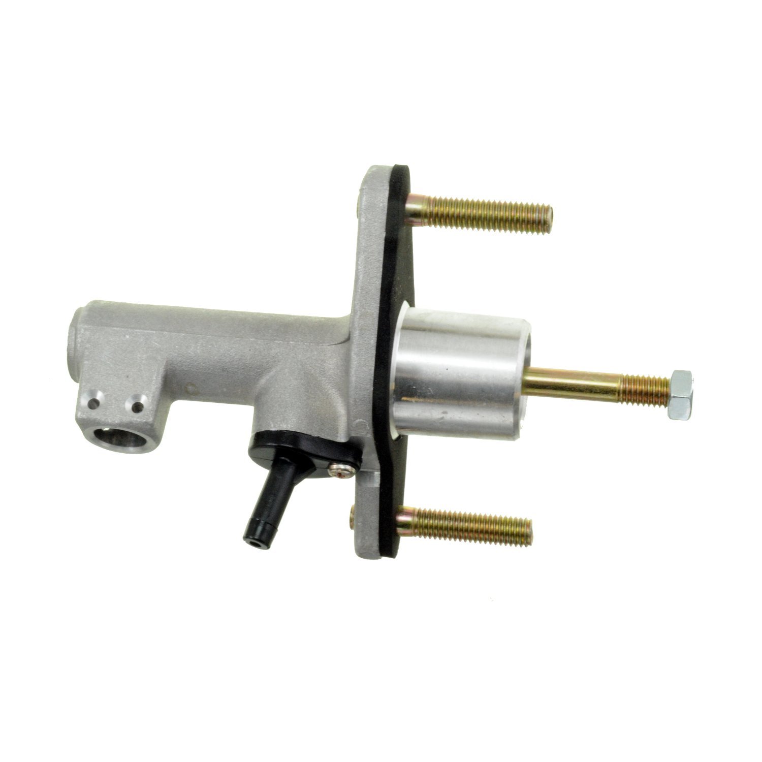

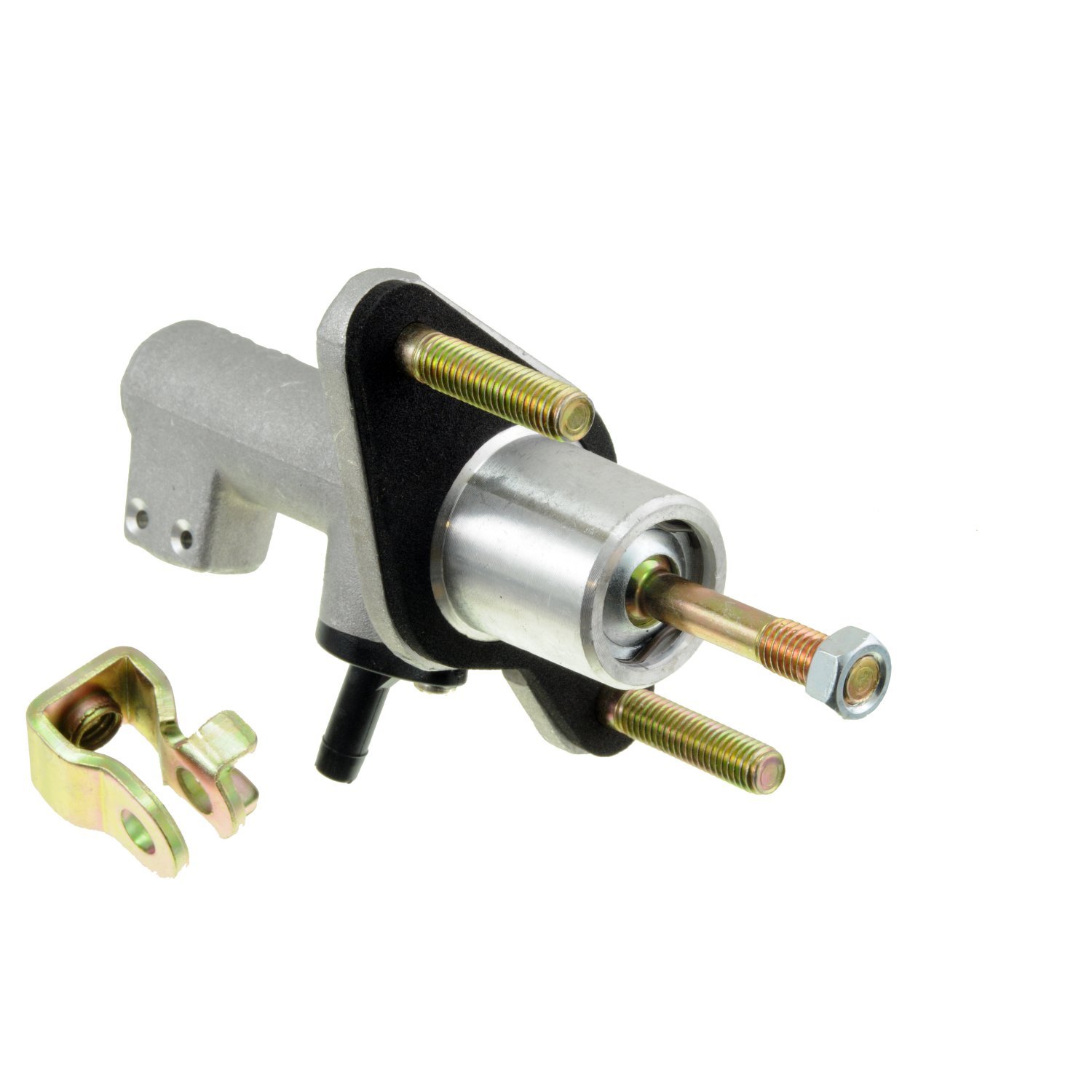

anyone know if the bolt pattern on the 02-05 Civic CMC is the same? because that unit looks like a direct replacement minus the CDV.
Amazon.com: Dorman CM640046 Clutch Master Cylinder: Automotive
all the images look identical to the GE version (including the C-clip pin) bot wonder if the 2 mounting bolts are in the same location.
I'm considering just ordering one, but would love to find the Sach part number crossover since this is an off-brand.

because the OEM one is $105, the aftermarket version is only $33.
Don't feel like blowing $100 if it doesn't work. Don't mind so much if it's only $33.
Just would like to see the clocking of the mounting bolts on the GE to see if they match this (2005 Civic non-Si)
this is the GE8 version for reference:
It's just hard to tell without them being side-by-side. a difference of a few mm can be a deal breaker.
I just want a REAL feeling clutch!
