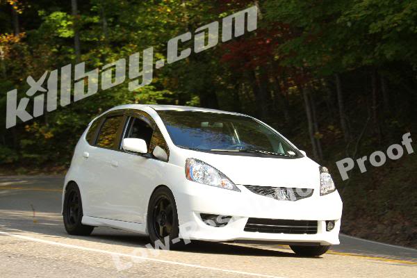

I have the ProKit...will post a couple pics incase you haven't seen any ProKit-equipped Fits.
