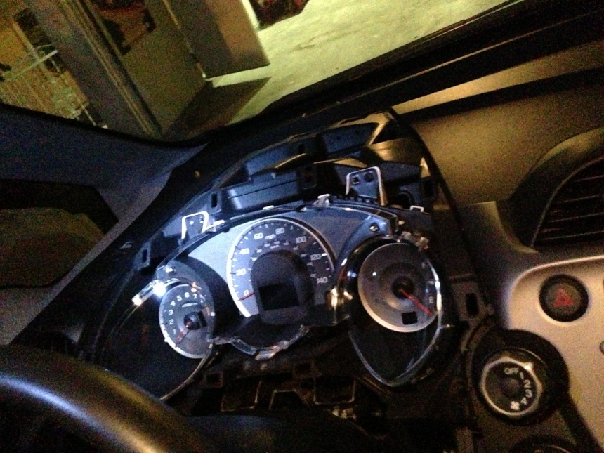

Originally Posted by Ein
First remove the knob that controls the brightness of the dash light (#3 on the first pic). It's bit tight, but just pull it out. Then insert a screw driver in the circled slot. Wrap the tip with tape if you don't want to scratch the plastic. I still scratched mine anyway.
Open enough of the seam to disconnect the wire to the mirror remote. Then just pull out rest of the dash by hand.
Buy at least two lenses if you plan to keep the car for awhile. No matter how much care I take. The lens still get scratches.
Important tip: Leave the new plastic lens in the plastic bag until you are ready to install. If you get dust behind the lens. It's worst than the scratches.
I bought my GE certified used a little over a week ago and was annoyed when I saw all the scratches on my lens. I found this thread, bought the lens and did the replacement myself tonight in about 15 mins.
For future reference, this is what it looks like when you remove your lens cover

You didn't need to remove the whole bezel, just the plastic cover
Also, I bought one of these:
Giottos AA1920 Rocket Air Blaster Small-Black:Amazon:Camera & Photo
What I do now is blow off the dust using that thing then I use a clean microfiber towel and I haven't noticed any additional scratches

It doesn't take 15 minutes, more like 1 minute. It takes 10 seconds to pull off the bezel (flat head screw driver or tools not required, just bare hands and an upwards tug at the switch) another 10 seconds to disconnect the wire.
Once bezel is off you use a flat head to depress the clips on your old scratched up lens and it pulls right out, probably another 10 seconds.
Goes together tightly and zero rattles. There's nothing that could rattle or create a squeak. You have no idea how simple this project is. I've gotta do mine again bc I wasn't careful and although I've got no scratches, I've got dust behind it which is just as bad.

It honestly could not be an easier replacement to do, just take your time and the directions are very straightforward
