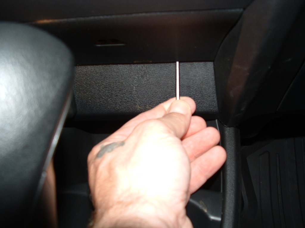

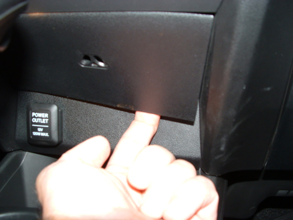

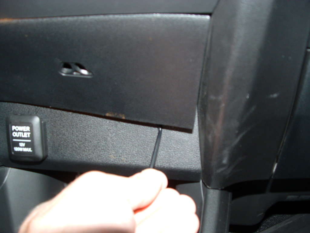

DIY bulb replacement
Ok here we go
This is the small you tube video I made.
These are the pictures

And I want a picture when you are done!

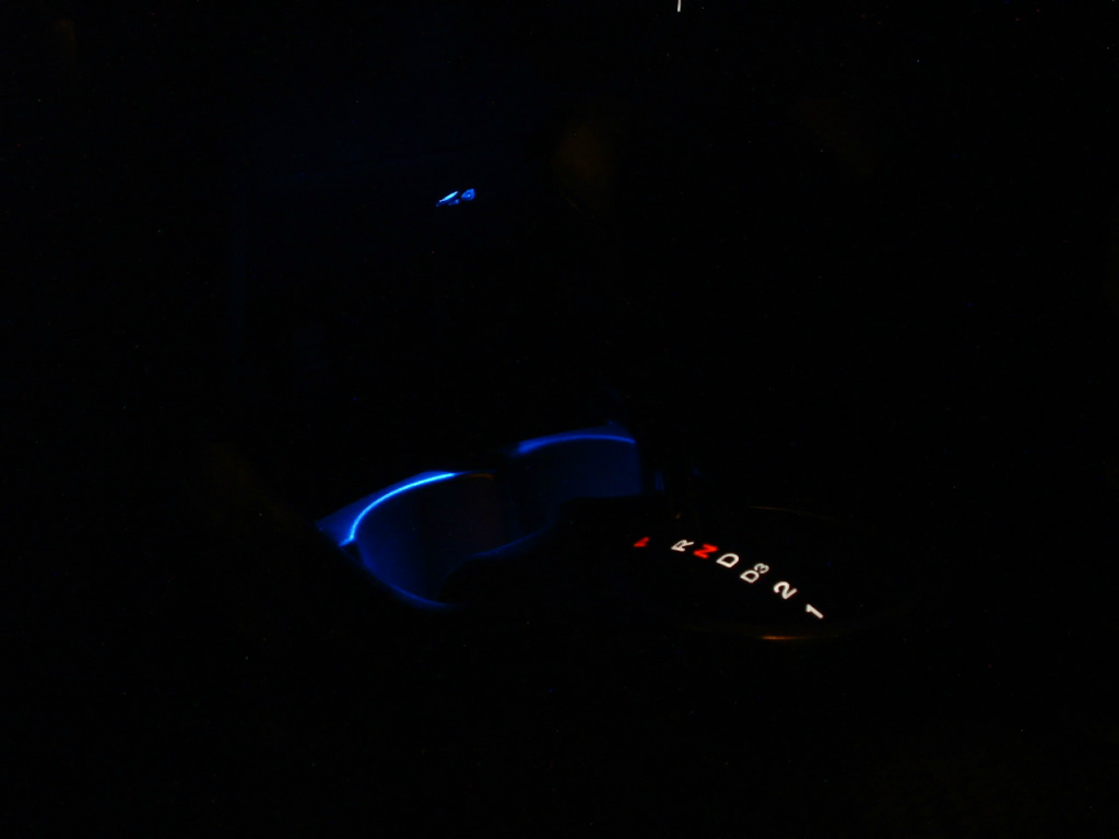

Since no one else can seem to post photos, here's one I grabbed while driving

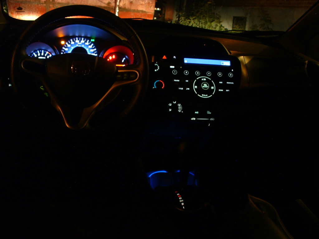

Challenge accepted! Here are mine:

Wonder what they would like like in RED
