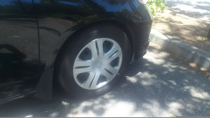

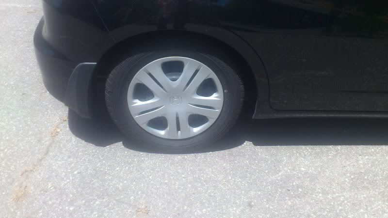

Sorry for cell phone shots, i'm @ work. 195/60/15 on OEM steel wheels. Car is lowered that's why it looks closer to fender. No rubbing or anything so not to worry about anything.

Hey thats pretty nice... and yes they dont even bulge much.. i hope the ride is more comfortable than stock tyres:-) did you notice any drop in fuel economy ? And thanks alot for sharing pics !:-)
