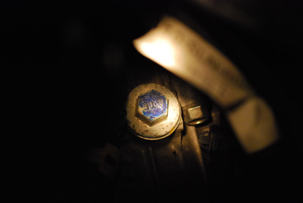

No... How about you tell why you think I don't know what I'm talking about?
Originally Posted by malraux
There is no fill plug....
Ummmmm.... >.> ................ <.< ................ ^.^
What's this?

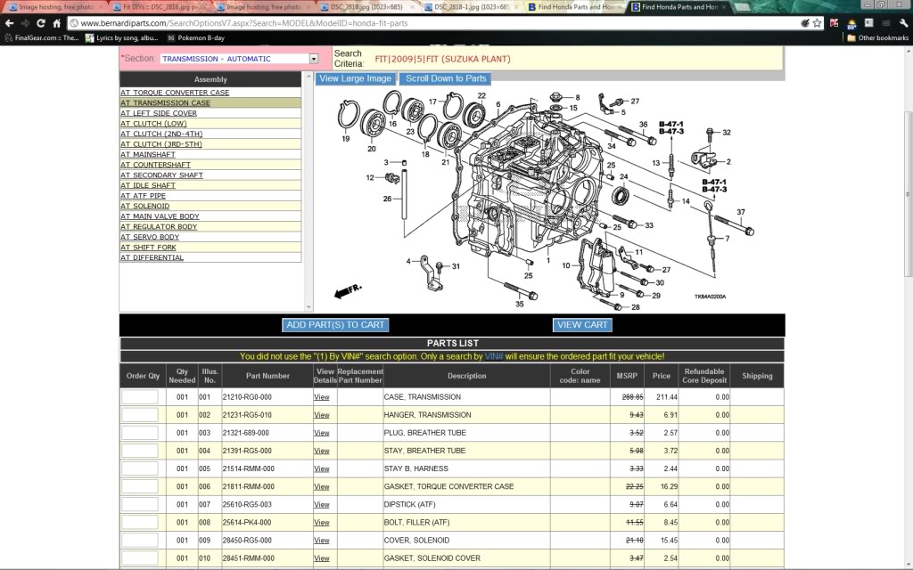

Mind you, this was on my GD... I'd take pictures of a GE but I do not have access to one at this time; however I do have access to this... Can you tell us what is the description says for part number 8 please?
Old Jul 7, 2012 | 07:46 PM
malraux's Avatar
Posts: 1,302
From: Louisville
I stand corrected, though as near as I can tell, you're never supposed to open that. FSM says fill via the dip stick tube, and I don't want to contemplate what a pain it would be to get access to that.

I checked Mitchell On Demand before posting up originally and was a bit confused since it did also list using the dipstick tube as a filling point (nothing wrong with it, I just prefer using the larger fill port) but nothing of a fill bolt and I knew GD transmission had a fill bolt; so, I checked on Bernardi parts for the bolt on the GE transmission.
