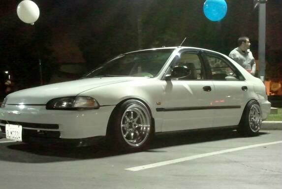

Dam All this for my train horn i feel loved lol Fuk the PIGS i pass but them in my eg all the time they never say shit they jsut look and smile Name:  NRHMeet2012.jpg
