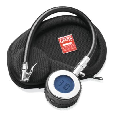

Anyone have a reccomendation on a good tire pressure gage? Thanks.
i use this one on all my cars. mine's from Griot'sGarage, but it's the same thing as the amazon one, I think.
Racing Tire Gauge With Bleeder Valve - Air Tools - Tools - Griot's Garage
Accutire MS-5510B Racing Tire Gauge : Amazon.com : Automotive Accutire MS-5510B Racing Tire Gauge : Amazon.com : Automotive

You don't need a good one. Not a performance application. I use some brookstone digital gauge. Works fine.
as long as it's caliberated it's fine.
but dont go cheap on tools especially when we're talking something that costs less than $100 which can potentially save your car and your life and others.
