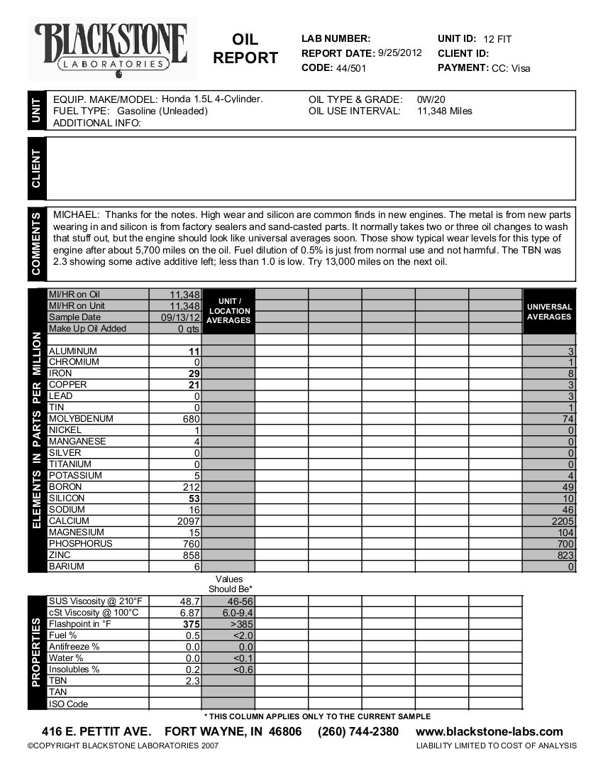

Saw the MM flip to 15% at 10,154 and then took it down to 10% left, and did the first oil change at 11,348mi. I sent it in to Blackstone Labs to see what they said. Basically looked good, and said to try to go for a 13,000 mi oil change interval. I replaced it with Mobil 1 0w-20 and a Wix filter, and put on a Fumoto valve while I was at it.

Thanks for sharing. Looks great and it proves Honda uses a very good oil. What got me confused is the TBN being so low with the additives being so high? It looks like a filter change might bring the wear items down and you could go another 10000 miles. Your molybdenum will be lower from now on too.

Your first oil change and it's at 11,348 and it's still good. Dam, I'm impressed. You are sure it's okay to use full synthetic oil on so new an engine? I thought you had to wait till you had at least 5k miles before you could use synthetic. Also, what is a Fumoto valve? Great post bye the way.

0w20 Honda uses is full synthetic or at least I think so, that is why the UOA is so good and still has most of the additives. I am impressed too. http://www.infineum.com/sitecollecti...a%20042109.pdf

Honda uses a synthetic blend. Good to know the MM is trust worthy to follow.

If you would've waited until 0% to 5% on the MM you probably would've reached 13,000 miles. So this report tells you the MM is indeed doing its job and can be trusted. Since driving conditions and driving habits change stick with the MM not miles driven.

Yea, I think I'm going to try to take it down to 5% or just as it hits 0% next time, unless it goes a year, and then I'll probably just change it around the year point. The MM does seem to be fairly accurate... it'd be interesting to compare against a newer model where the MM went to 15% at a much earlier mileage to see if the oils are in relatively the same state. This had two 3000+ roundtrip road trips on it and a trip up and down Pikes Peak.
The oil recommended in 2012s is now 0w-20 which only comes in synthetic. I think all older models have been OKd to use 0w-20 as well, as was mentioned in the link posted above, but I think it's actually happened at this point.
A Fumoto valve is a small ball valve that goes on in place of the drain bolt to make future oil changes a bit simpler and hopefully less messy.

I figured 0w20 came in semi synthetic oil. ConocoPhillips is the maker but still dont think its worth the price they are selling it compared the their 5w20. My point with the UOA is with over 11000 miles the additive package still looks better than most you can buy off the shelf at Walmart. Synthetic oil is the only oil to hold up to that mileage and not use the additives. That is why if you can filter down to 1-2 microns the oil could last a lot longer with a oil analysis. http://www.conocophillipslubricants....0TDS%20Web.pdf
