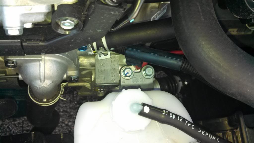

Just updated my grounding, so you have a better idea.
These pictures of mine are huge! Beware!
http://i244.photobucket.com/albums/g...ps1d87d549.jpg
http://i244.photobucket.com/albums/g...ps9253bdbb.jpg
http://i244.photobucket.com/albums/g...ps6ec55929.jpg
For those who dont wanna load the big pictures, I grounded using 3 wires total. 2 gauge from the radiator support, 8 gauge from the lowest left intake manifold bolt next to EGR valve, and from left bolt on clutch slave.
This gives me bigger grounding from the left, center, and right of the engine bay, and that left one is a nice huge 2 gauge fit for a nice stereo I will be installing in the future
