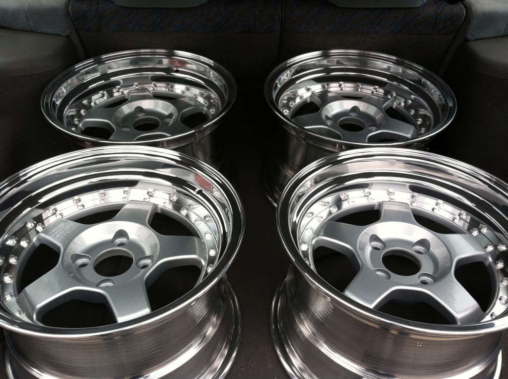

Classy you say? Not bad for $800 shipped for American Made wheels....
mmmmm...
