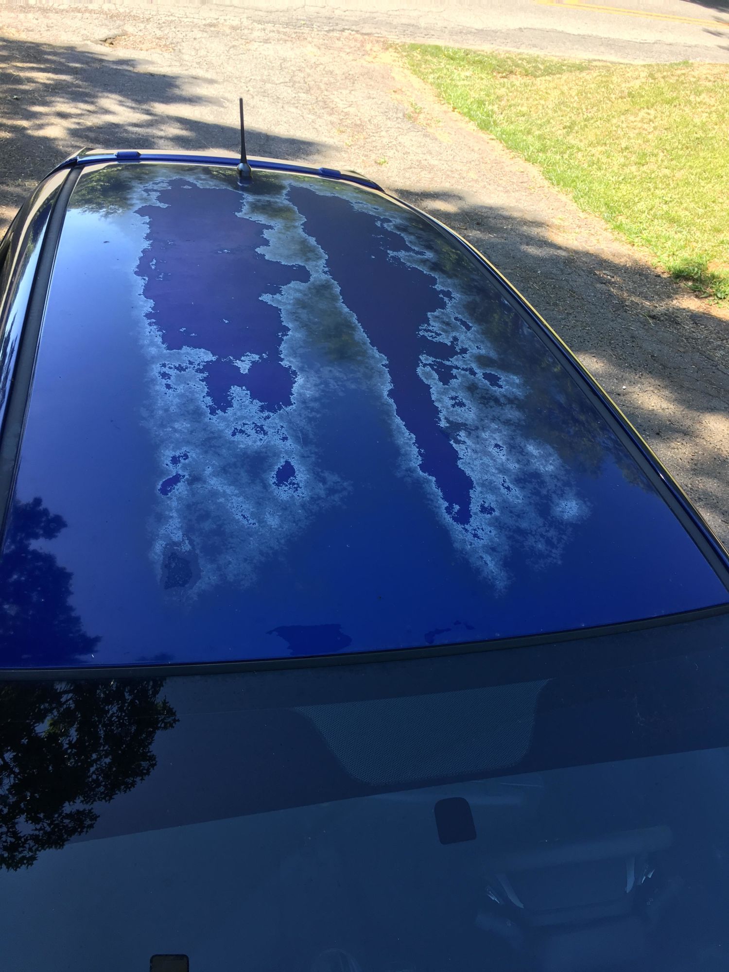

Old Jun 16, 2016 | 10:22 AM
  #54
mchoffa's Avatar
Posts: 91
From: Canton, NC
My '09 Blue Sensation paint looks absolutely terrible on the roof and hood. The car looks like a piece of junk compared to just about every other '09 car on the road. I'm sure the resale value will take a hit. Thanks Honda.

Old Jun 18, 2016 | 12:36 AM
  #55
dwtaylorpdx's Avatar
Joined: Oct 2015
Posts: 1,465
From: Portland Or
Blue was the color that gave up in the 80's and 90's on all the Chevy and Ford cars and trucks.. Blue is very sensitive to UV according to a buddy of mine that does restorations, says its the easiest paint to sand off a car.. Anecdotal but makes me wonder..
