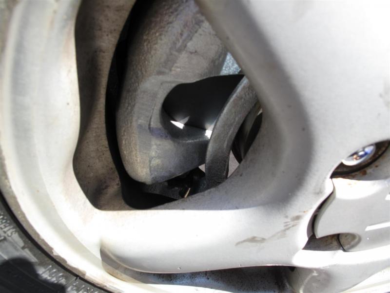

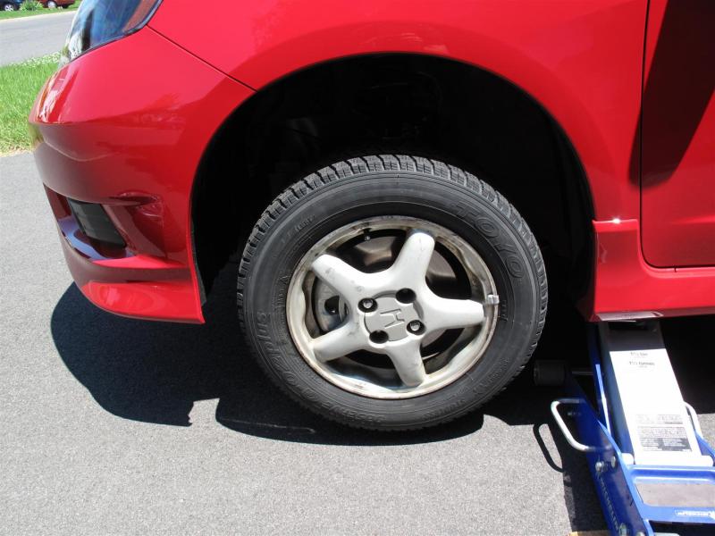

So, winter wheels fit perfectly. I also kept the spare tire of my 1999 Civic because all AT Fit in Canada don't have spare tire! The spare tire won't fit in front, but does in the rear...

Here is a picture of my 1999 Civic wheels on the Fit...
