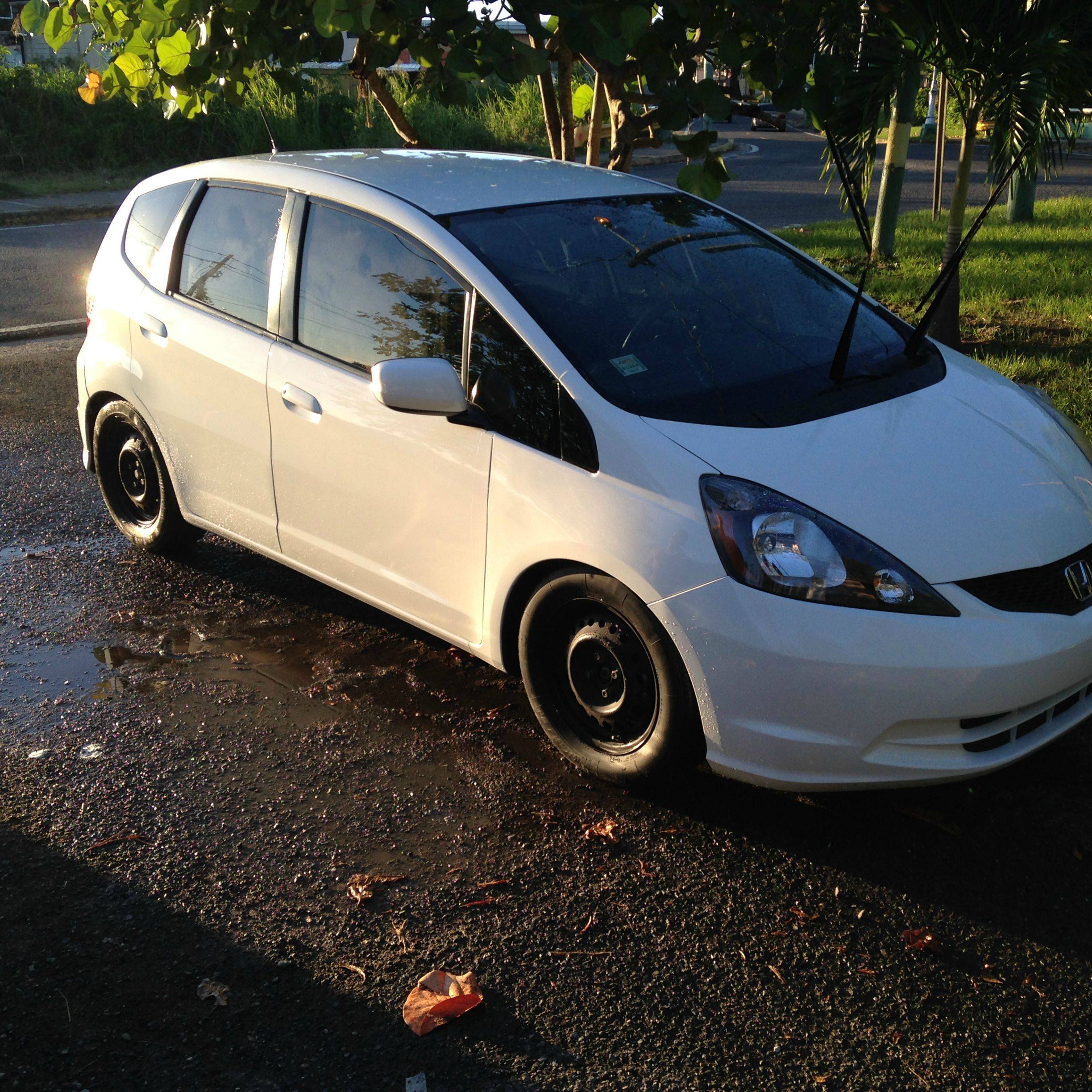

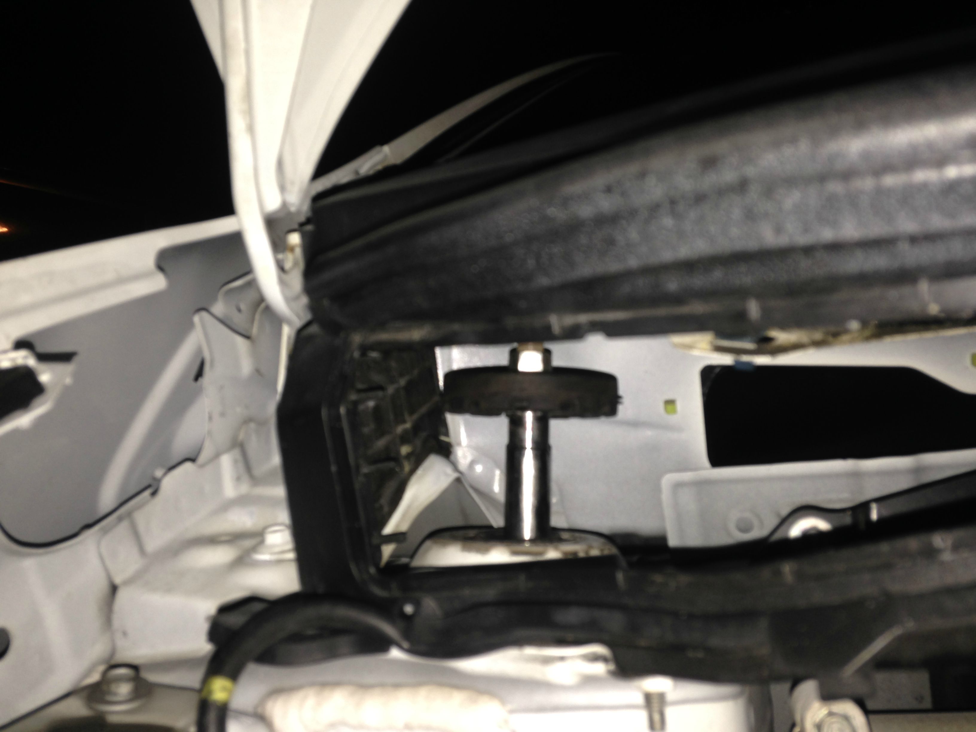

Well i installed Fuction and form coilovers, been using them for about 3 weeks now and this happened , any tips? bad installation? malfunction ? any way to fix this ?

Cars wsnt too low normal

Looks like you may have forgot some pieces or the order of assembly was wrong. Properly installed that is impossible. There are a lot of bits in there and the order of assembly is confusing. I've had mine off all four corners three times now and still need to check a picture I take of disassembled parts layed out in order as soon as I get one side completely off for the fronts.

^ I agree. You might wanna stop driving on that immediately. It needs to be taken apart and reinstalled correctly.
It's possible something was damaged, but either way, you gotta take it apart to find out.
