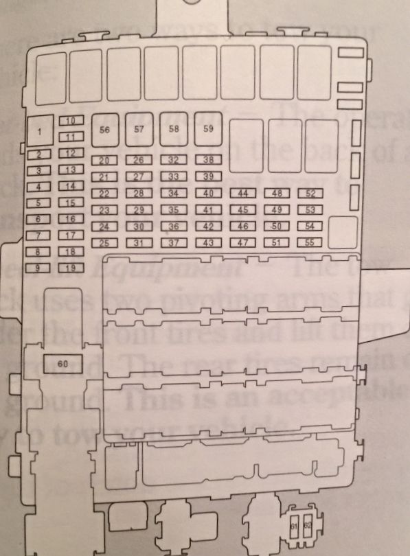

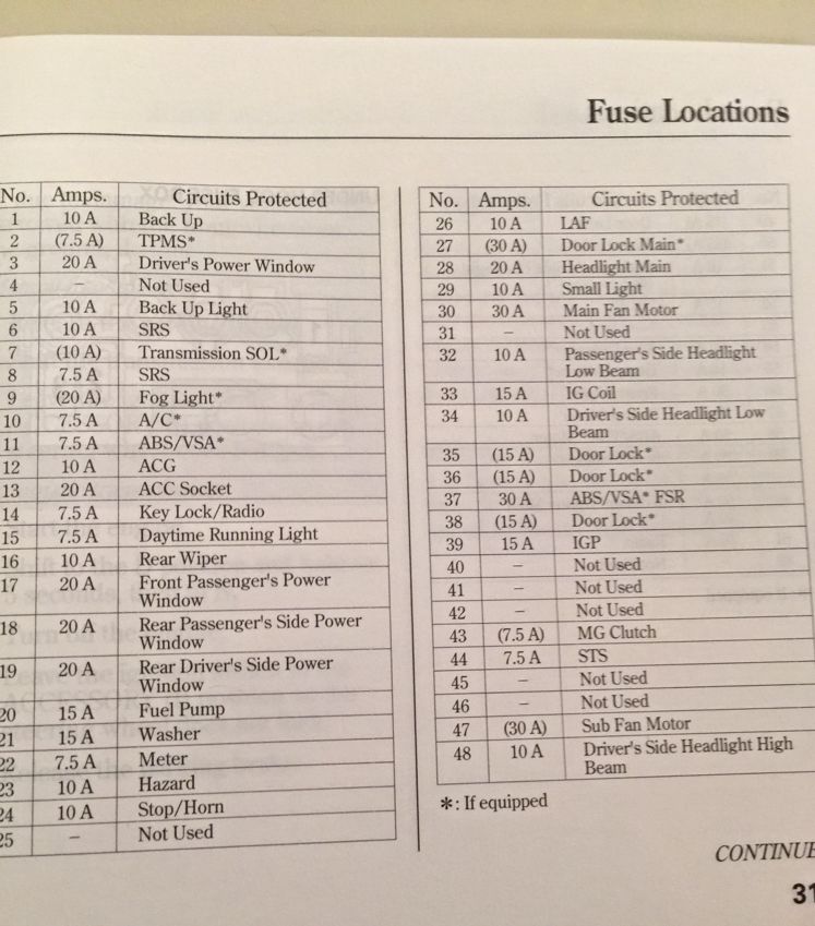

Got new tires a few weeks ago for the Honda..... Damned TPMS light has been on AGAIN ever since..... Found the fuse to make the yellow "TPMS" disappear.... thought I would also post the fusebox fuse locations and denominations if anyone needs the info:
