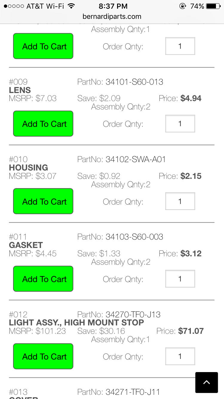

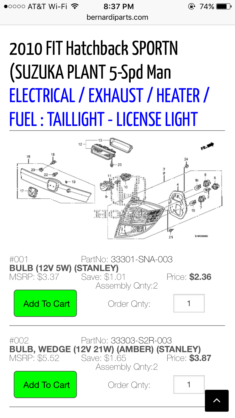

You could also price it at a dealer for starters. Benardi Honda will take online orders. I "think this is the part # that you want.
PartNo: 34270-TF0-J13
It is $71.00 at Benardi Honda (online) DO NOT ORDER this without independently verifying this number.
Honda Parts Now and Discount Honda Parts also have it online in the $70.00 range.

On the GE the brake light LEDs cannot be replaced, you would need to replace the entire brake light which is very easy, just 2x 10mm bolts.
Attached Thumbnails Where to buy third brake light? 2010 Fit Sport-80-img_9097_a0c285307487286b0c20aee81e3411cacc9e032c.png   Where to buy third brake light? 2010 Fit Sport-80-img_9096_af963b649ea5ef03fe44be08f1563e68ff4854f1.png
