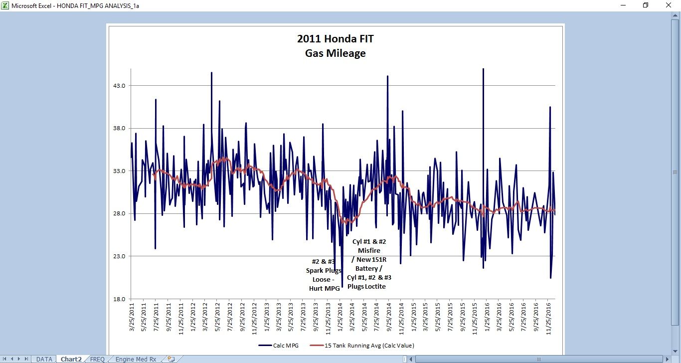

You can see the MPG on my 2011 Sport AT jumps around a lot and that is the reason I have the red line which is the average MPG for the last 15 fill ups.
You can see how loose spark plugs hurt my MPG in late 2013 / early 2014.
The overall trend is going lower because I do less and less highway driving. 85% local anymore.
