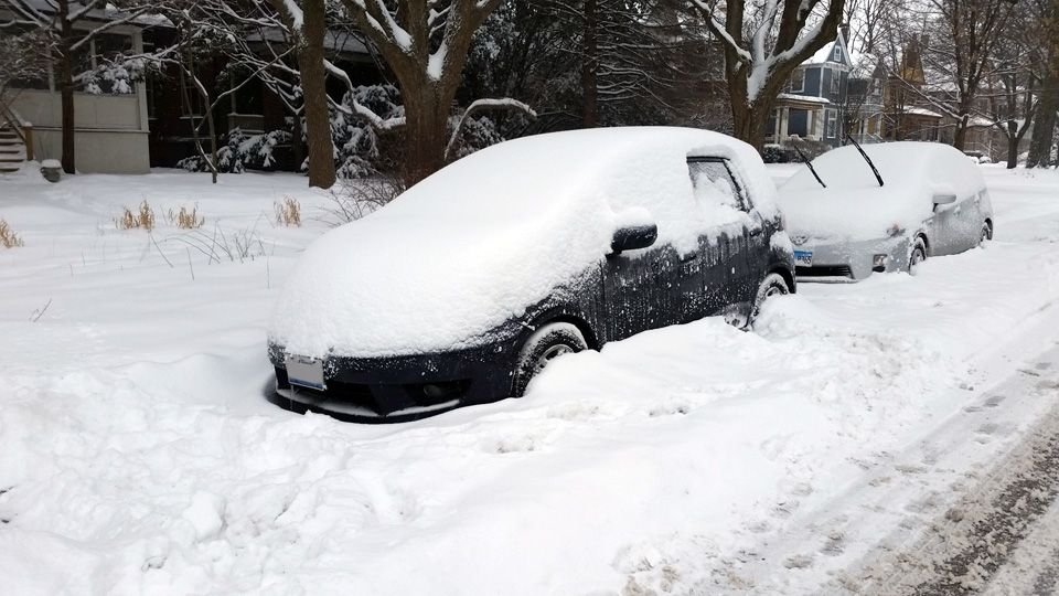

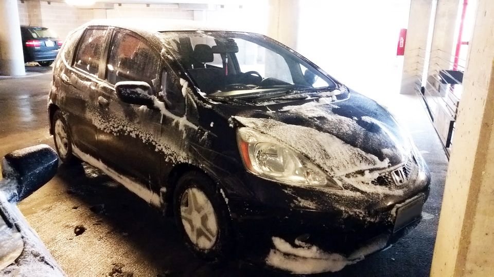

14" steel wheels from the base GD Fit like the ones also clear the calipers of our 2009 Fit Sport. Got them wrapped in 185-70-14 General Altimax Arctics.

Smaller rim with taller tire........ Would you say ... the Height is about the same? 185-70-14 compared to 175-65-15

The 175/65-15 needs to revolve 8.4 more times per mile than the 185/70-14 according to an on-line calculator. Tire Rack.com shows 6 different snow tires (with / without stud holes) in the 175/65-15 size.

So with the14" rim higher profile tire with the greater load range(load range may or may not be relevant here)... yields taller tire.....

Yes, you'd want to maintain as close to stock tire circumference as possible. $45 per tire before tax (185-70-14 General Altimax Arctic @ Discount Tire) and install was a great deal!
