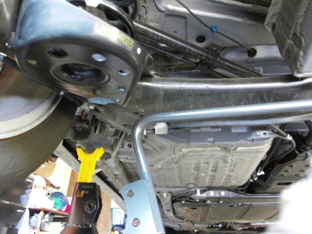

So I only read about the sway bar installs, but never a tutorial with pictures...
forewarning: folks with the mental thought of "bigger hammer works better" may not apply for dong this job.
time: estimating how long it should take, suiting up, setting up, with pictures 1 hr.
tools- hex key (forgot what size, but metric), 17mm wrench or socket, standard screwdriver, jack and jack stands
item list- 1 progress rear sway bar, 6 each of nuts, washers and allen bolts, instructions, and 1 sticker!!!!
1- jack up the car where that rectangular thingy is, after the jack stands are in place, lower the jack and use it for holding the bar Name:  e23d8c2f.jpg

Thanks for the DIY. I'm expecting to receive my Progress bar any day now. I read a DIY for this install (can't remember where) that included removing the lower shock bolts and removing the lower shock out of its mounting bracket. I take it this not actually necessary?
Old Dec 7, 2009 | 10:16 AM
mole177's Avatar
Posts: 877
From: Armenia, So cal
no. you dont even need to remove the rear wheels.
just make sure you have clearance to pop in the allen bolts from top side.
