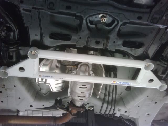

-OKUYAMA CARBING lower arm bar

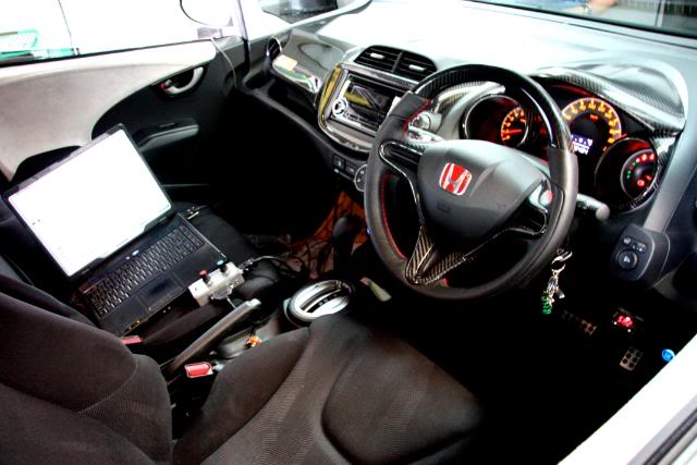

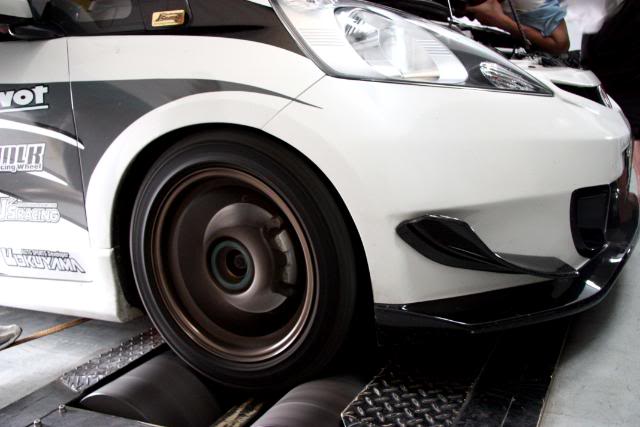

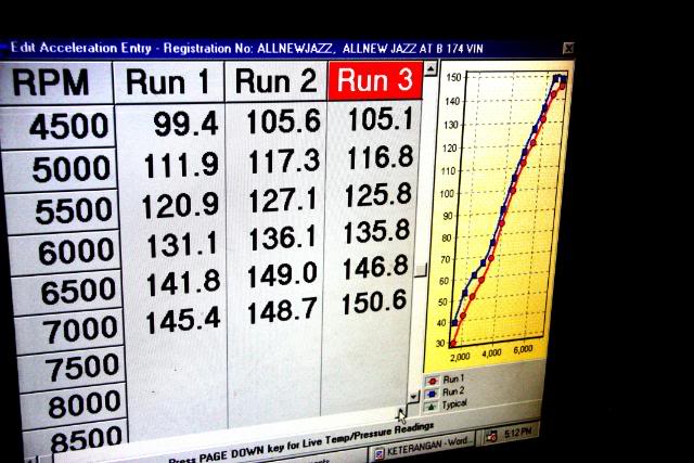

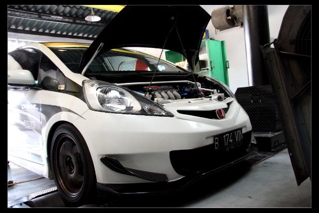

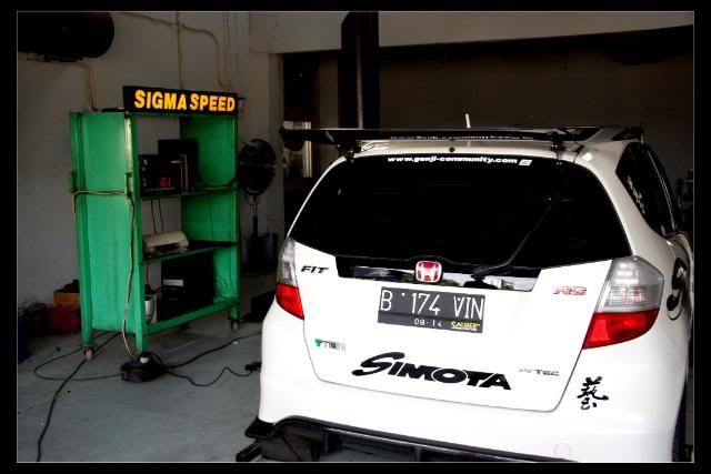

After using DASTEK UNICHIP TYPE Q+ , i've got 150.6 hP for POWER and 166.4 NM for torque on engine!!
The car is an A/T transmission!!

Carbing Lower Arm bar

Damn I want that strut bar! I'm currently using the Cusco one. I wonder if that will clear the brake reservoir of LHD models?

I'm waiting for Carbing to release everything in aluminum, the current front strut is like 5kg, too heavy for my liking even though I am wanting it I'll continue to wait.

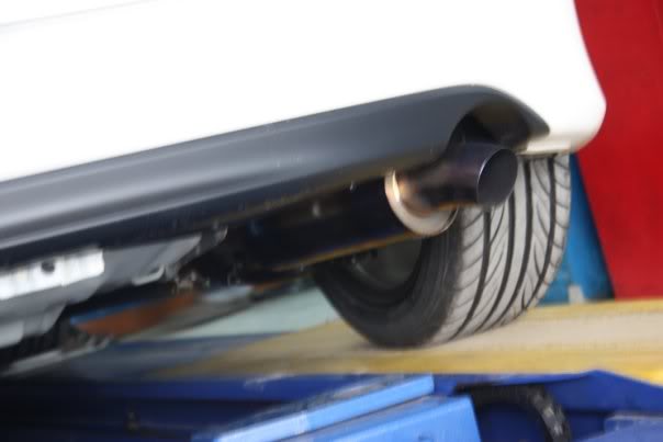

What's up with the so-called "rear diffuser"? Is that an add-on, some type of overlay, or did you just paint it black? I don't know... looks like more than simple paint to me.
Looks good. Oh, your entire car looks nice too!

annunC8, in that photo the diffuser is not present. Look at pic #1, it's the only one where the diffuser is present. That's just the stock bumper and how it comes at least there and here, possibly other places as well.

Ok. It just looked different to me, for some reason. Maybe it's the black-on-white that threw me. Then again, believe it or not I've never seen a white GE8 live and in person.
hehe... that's when the car just came ! so it haven't use the diffuser at that time.. please see the first picture, the one that use full bodykit JS RACING.. that's the rear diffuser

wow i love that carbing bar. do you have any vids of your car. i cant believe you got 150hp for your car. hate to say it but i kinda dont believe it. but other than that it looks really nice =D
edit. nvm if you pnp i can understand that

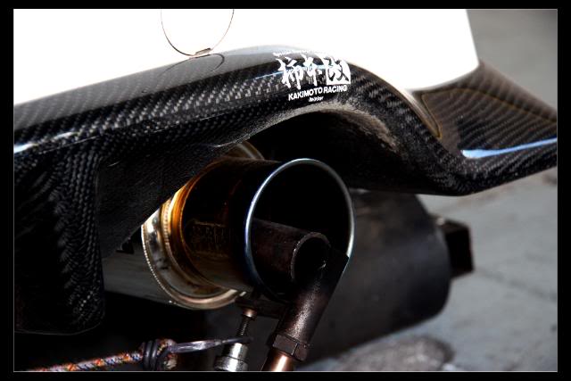

What made you decide to go to the heavier rear canister from Kakimoto from the J's?
do you mean the Muffler parts??
before i use J'S racing titanium muffler. Since my car is a A/T car.. the js muffler makes me feel no power in Low end RPM.. after i consulted about it with the local exhaust specialist, they said that J'S muffler is suitable for M/T car and more suitable in circuit use..
and the Noise is quite annoying, since i took off the CC..
so it brings me to pick a new muffler.. i choose kakimoto racing muffler because the design is quite unique to me, and the sounds is tolerable in Low RPM, but Sounds cool in High RPM.. also there is no low end power loss like JS racing..

video?? sorry i don't have it.. but later i will make the 0-100 KM/H video...
he he.. yes i also did porting and polish my car , including 3 angle valve job and slyp head about 0,7mm from stock engine
believe it or not.. i posted the result on dynotest machine.. let the numbers speak themselves
