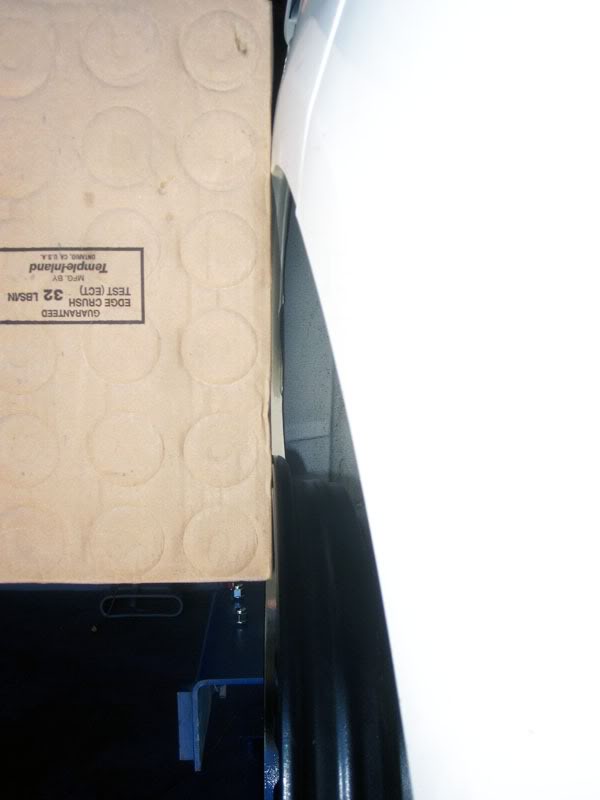

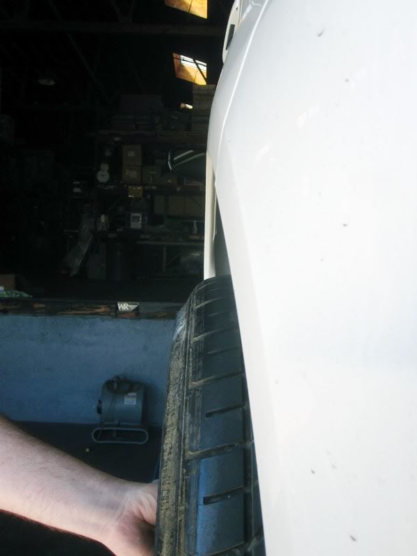

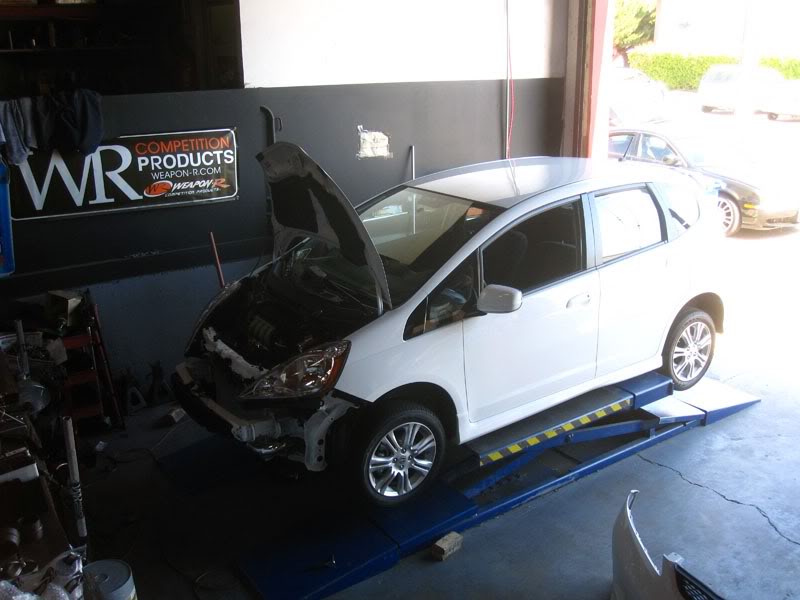

I tried out some wheels that I wanted to run so check it out the first picture below is the 18x9 with a 20 offset and as you can see they stick way out! so thats out. Next picture is a 18x8 with a 40 offset and its HELLA FLUSH!!! but it dont think its going to clear with a tire on it and its close to a piece that comes from the rear suspension arm. Now I am going to make a few calls to see about some 17x7 and some 16x8 wheels. I am on a quest now everyone hahaha

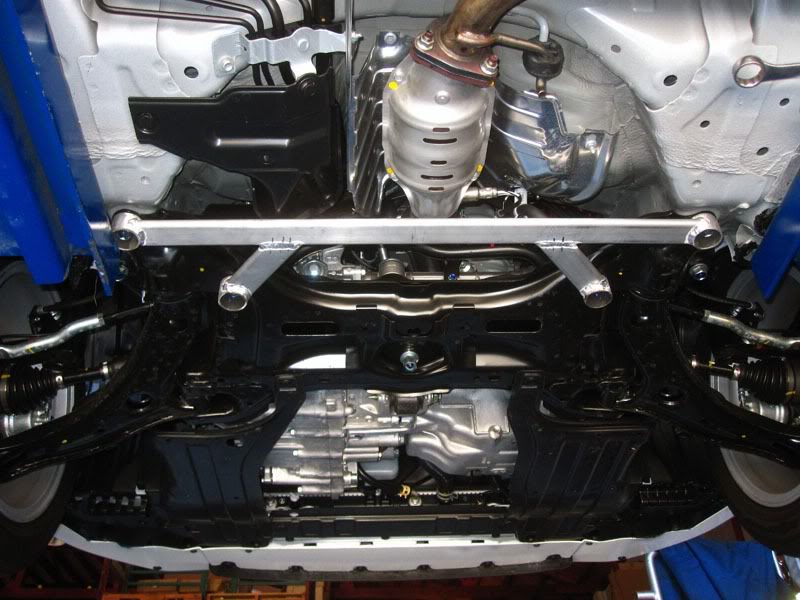

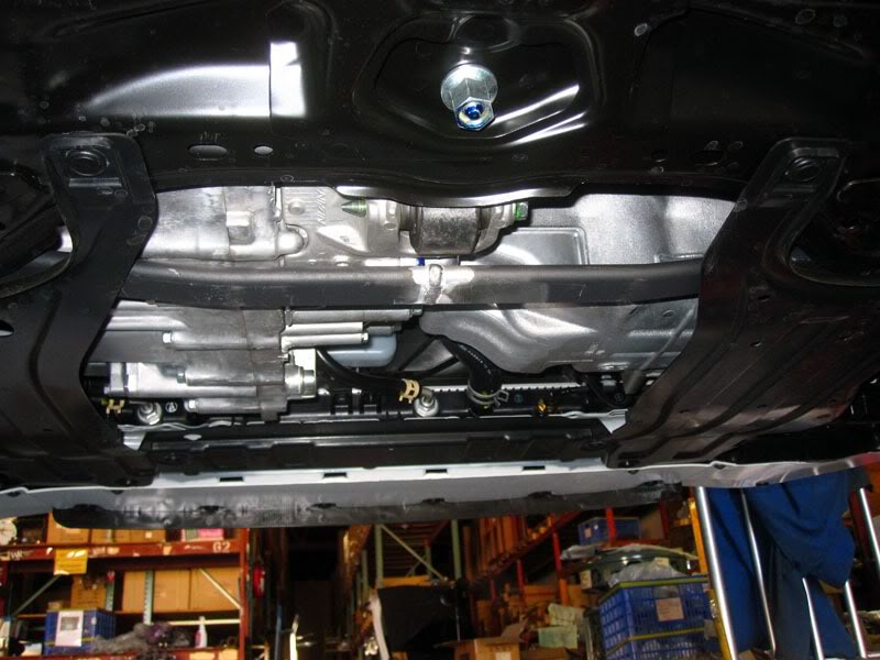

after that I made up the lower 4pt and 2pt tie lower tie bars today for the car. The 4 point bar requires you to remove that cheap flimsy bar that honda put in so this can clear. The front 2 point goes onto the from A-arm bolts Ill take better pics tomorow.

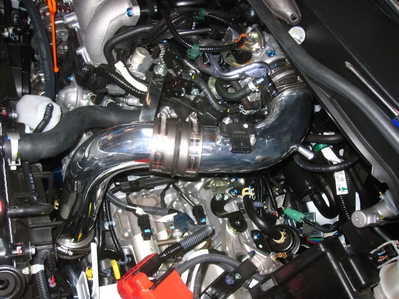

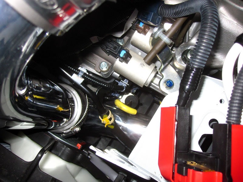

Alright well today I didnt have that much time to work on the car so all I got to do was install the cold air intake. Heres a few pics..

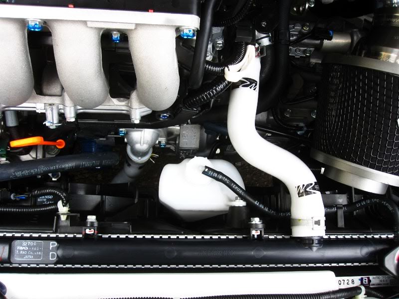

Had some time to install the upper and lower radiator hoses

Aren't you worried about the intake sucking up some water right there Those hoses look good but I wouldn't want to clean them for sure

The intake is modular so you can make it a SRI if you notice my pic showing the coolant hose you can see the intake is currently a SRI. The coolant hose will be a pita to clean but then again we dont have clear/white available we do have red blue and black tho so no need to worry hahaha

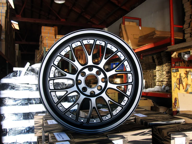

Ok these came in today for the car and Im still waiting for the tires to show up as well.

Hey guys the wheels are from XXR and they are 17x7 +38 they are gonna be wrapped in Falken FK-452's 215/40/17 also the rivets will be changed to red soon too
