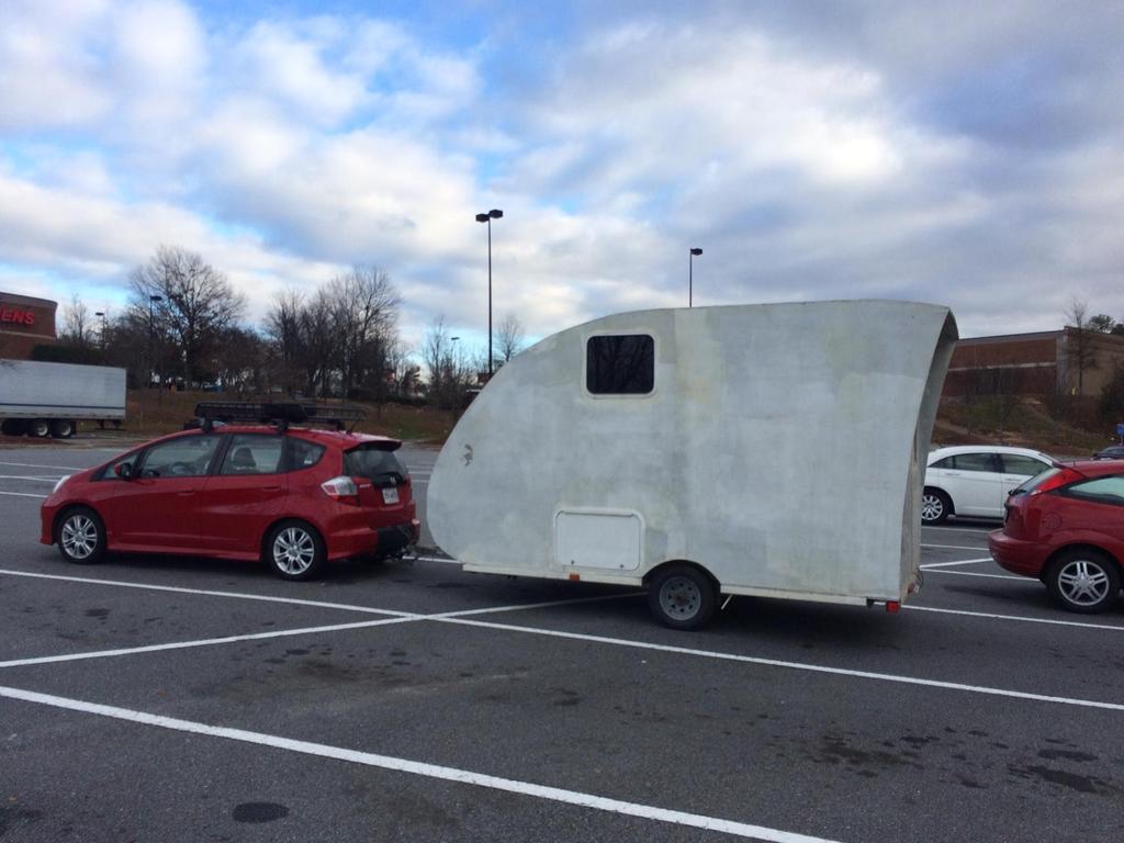

I don't see why people fuss so much about towing.
There's risk in doing ANYTHING. Just drive slower and leave more room. I could buy a truck and pay two insurances, worry about more maintenance, get terrible gas mileage towing, and have it taking up room in my driveway... Or I could just use my Fit.
I built a camper trailer from scratch a few years ago. It's been sitting outside at a friend's house (he was using it as a guest bedroom ), but I recently picked it up to refinish it. The exterior didn't hold up too great, although it did keep out the weather and the interior is perfect still. The Fit worked great, but was strained on the highway. I didn't get it over 55mph because I didn't want to work the engine too hard.
The camper is about 20' long, the actual interior is roughly (just under) 15' long x 7' high x 7' wide.
Since it's custom built, it's light. The framing is all 1x2s and 1x4s, and the interior and exterior sheathing is 5mm luaun plywood. It has about 50lbs tongue weight and weighs maybe 1000lbs at most. I refurbished the metal frame, built the base and walls separate, then lifted each wall into place by myself (each wall weighs just over 100lbs). After that, I connected the walls to each other and to the base, then filled in sheathing on the outside and inside. If I could do it over again, I would have probably used some sort of metal sheathing on the exterior in addition to paint, but that's ridiculously expensive. I'm under $2000 in on the project and learned a LOT building it.
I would agree that the weight is not a problem, but WOW that is a large mass to pull down the road. The wind resistance alone is probably the equivalent of trying to pull 3,000lbs or so down the road! I bet you get some looks towing that rig with the Fit.
