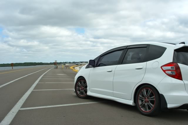

I put a set of 30mm. looked great, but i couldn't make a turn without the rears rubbing.
stock size for the 09 sport rim is 16x6 53mm offset.
i had to take them back off. now i need to decide if i want to roll the fenders (gotta find someone to do it), get a smaller spacer (maybe 15mm) or just get a wheel with an offset around 30-35.
pic for reference... hard to see the tires though.

r u sure it was the rears? did u put spacers on the front?
i have 205 tires on +41 wheels, so the outside edge of mine basically moved 22mm. the rears don't rub, but the front do on fast bumpy turns.

I'd say only roll them if you get aftermarket wheels with an aggressive offset (30-35). Otherwise run 10-15mm spacers with the stock wheels and it'll be sitting nice.

I only put spacers on the rear, so yes I'm sure. I have 205/50/16 tires. A 15-20mm would be perfect I think.

you have 205s AND 30 mm spacers? wow... no wonder.
i think the 15s or even the 10mm spacers are your best bet.

J, i think your current setup looks terrific and will be better with 10 mm spacers in rear. Should you decide on new wheels though the top would match your car better IMO. Oh, your visors are the oem i presume?
