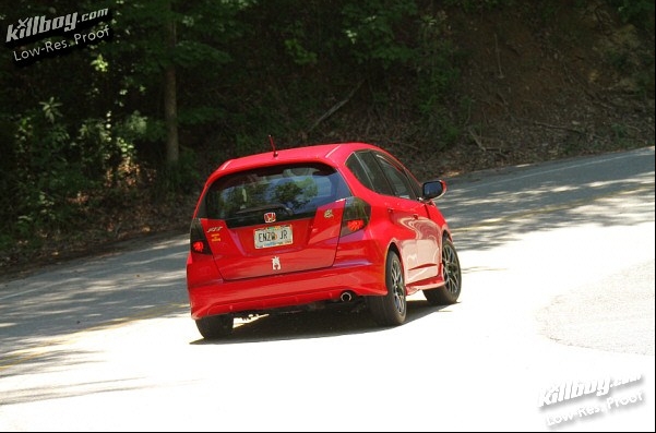

I have swifts, a progress rsb, and 215s. Body roll is still there, so no, it doesn't get rid of it.
H&R springs, Progress Rear Bar and......Yes, there is still plenty of body roll!!
